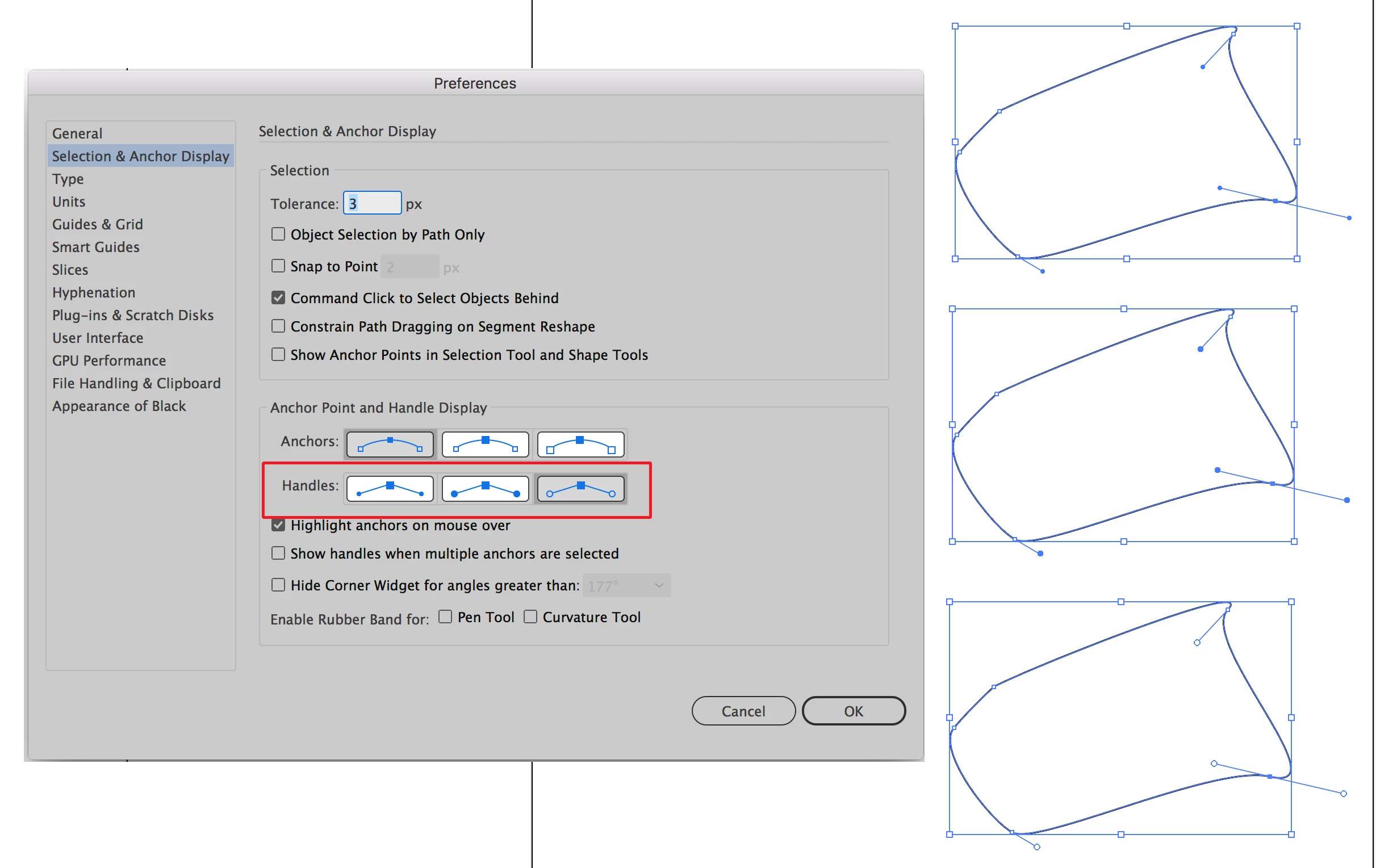

In the current version of Illustrator CC 2017 you can adjust the size of the handles through the Selection & Anchor Display section of Illustrator Preferences. See screenshot:
As you can see there is a noticeable (if slight) difference in size between the options.
