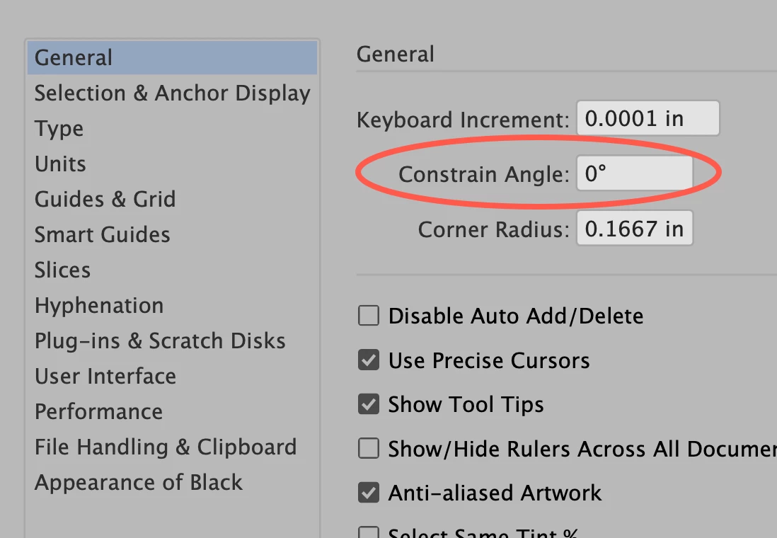

New to Illustrator, everything was going fine.  Today I opened it and went to work on something and when I clicked on the type tool to make a line type, it was slanted so as you typed it would go up and to the right.
So when you'd make a text box, it looks like it's angled to the left about 15-20 degrees.  I have tried everything to figure out what happened and how to fix it but I can't.  I didn't change any settings.
Type on a path still works normall, it's Text in a line or box that is totally slanted now on an angle.  How can I reset this to normal orientation?
Thank You
Correct answer tromboniator
Go to Preferences > General and make sure that the Constrain Angle is set to 0°.

tromboniator
tromboniatorCommunity ExpertCorrect answer
April 2, 2020
Peter

Kurt Gold
April 2, 2020
I'm not sure about that issue and probably I misunderstand it, but have you already checked the Constrain Angle setting in the Illustrator preferences?
