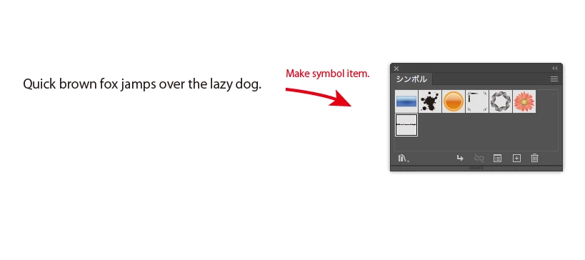

Here is a typical workflow in Illustrator.
Input text and add it to the Symbol panel.

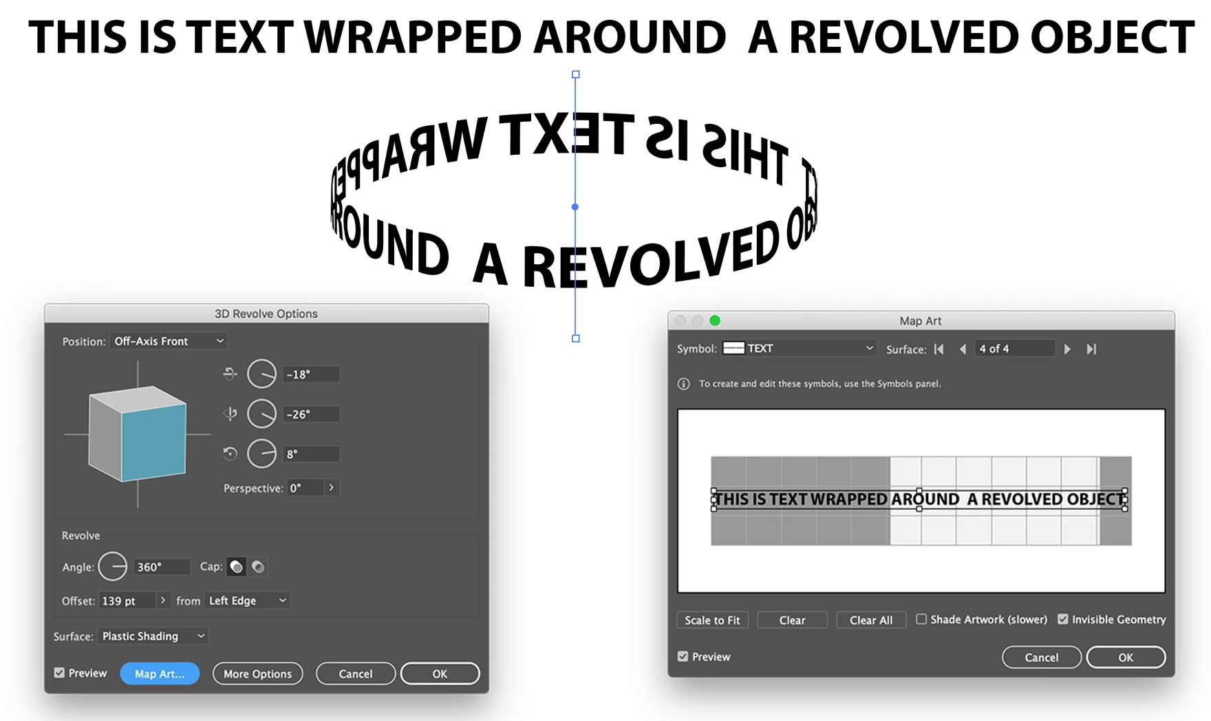

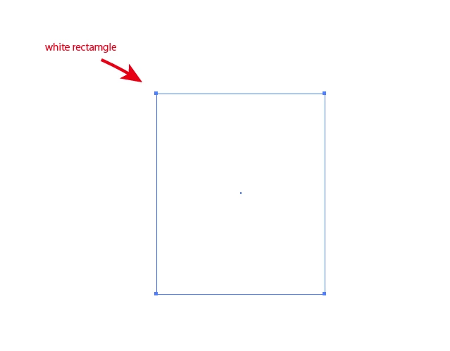

draw a rectangle.

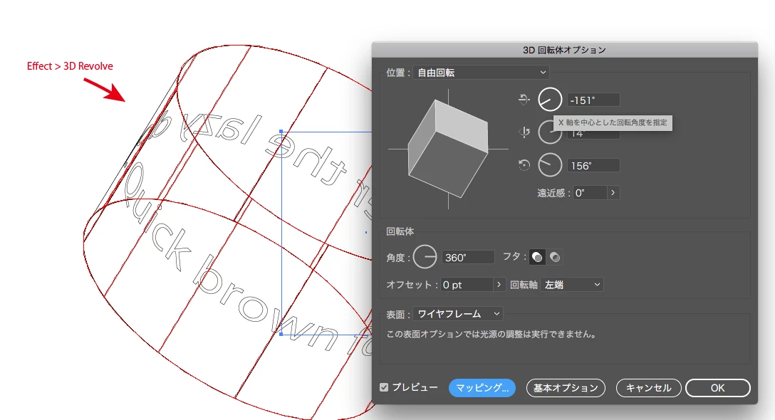

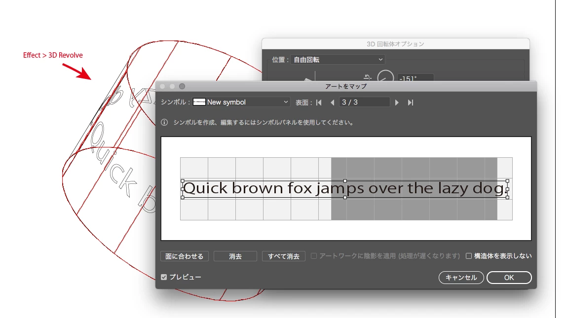

choose the menu "Effect > 3D > Revolve" and set the surface to "wireframe" and apply surface mapping.

Create your text and add it to the Symbols Panel.
Draw a vertical line.
Use the Effect > 3D > Revolve.
Offsett the Revolve Effect and use Map art to apply it to the revolved object,
Check the Invisible Geometry option.
