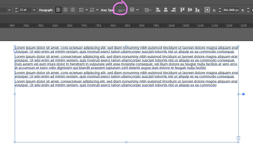

I'm having an issue with text not bottom aligning within the text frame. I have the Area Type set to bottom (as pictured). The text within the frame will align to the bottom as I am resizing it, but after I'm done resizing, the text moves back to the top of the text frame. I can't figure out why it's doing this.

It seems the text is not connected to your text box. Try to click on the blue handle on the right of your text box.
How to manage text area in Adobe Illustrator
