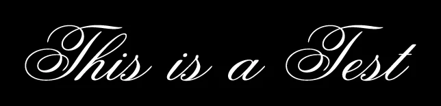

I guess SLIGHTLY thinner would be a better description, but there definitely is a difference between the two.
It's easier to see with the white text on the black background.
STROKE ADDED:

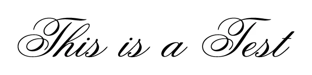

STROKE ADDED & FLATTENED:

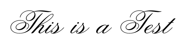

STROKE ADDED:

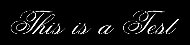

If you do this kind of stuff, I'd rather do it by applying the effects Offset path followed by Outline object.
Outline object will simulate the outlining of text. Outlined text gets rendered differently, which might cause this weight difference.
