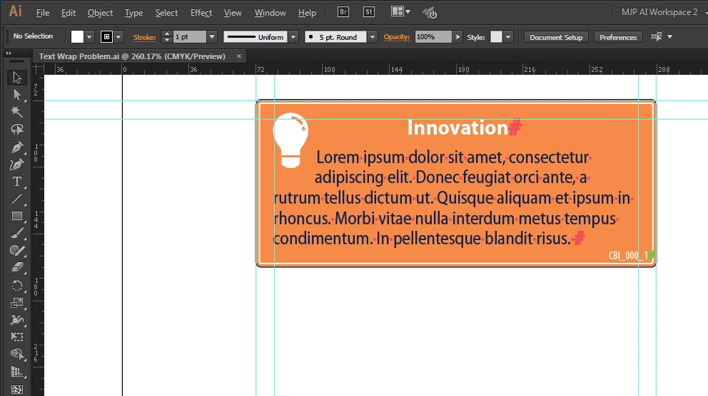

I have created a small small call-out graphic for use in a business document in MS Word.
In the graphic I have created a text wrap on the lightbulb.
This is what I see in Illustrator:

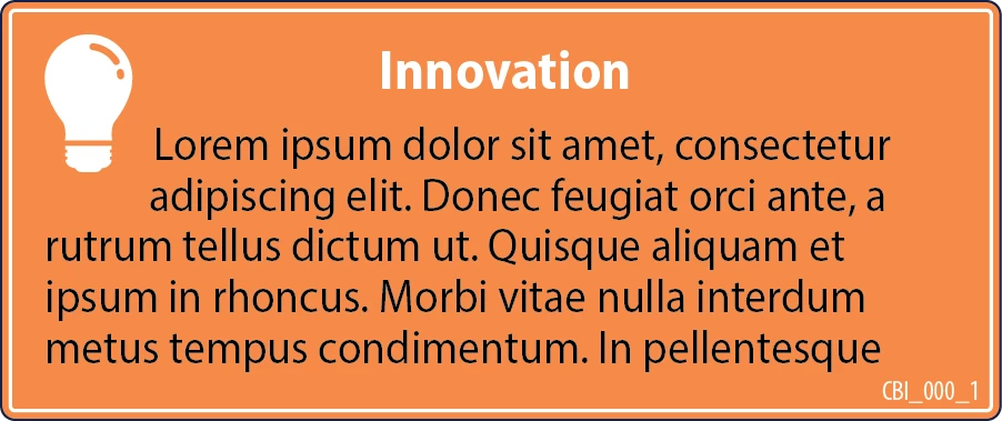

When I export as a png file, the text on the right has a wider margin (even though the element with the wrap is in the upper left) and text is cut off.
Exported as a png:
Is this a bug and the text wrap doesn't work?

I looked at the two images you posted and the text in the exported image has wider tracking than the screenshot from Illustrator which is why it appears that the wrapping is incorrect. I created a text box and filled it with the same text and found that the original text in Illustrator was using tracking of about -55 and the exported image was using tracking of -20.

Did some tests and I found that there is indeed a problem with using text warp and how you export files. The previous method, which is now 'File > Export As,' results in the correct output with the text wrap being honored. If you use any of the new options, which all use the new Asset Export method, result in incorrect output.
Image on the left is how it should appear and is how it does come out using the legacy output method. The image on the right is how it appears when it comes out using the new Asset Export method.
The odd thing is that even though it's a bug with the text-wrapping that the leading in the text was different. It's possible that there is something additional in your file that may be contributing, but at least you know how to work around it.
