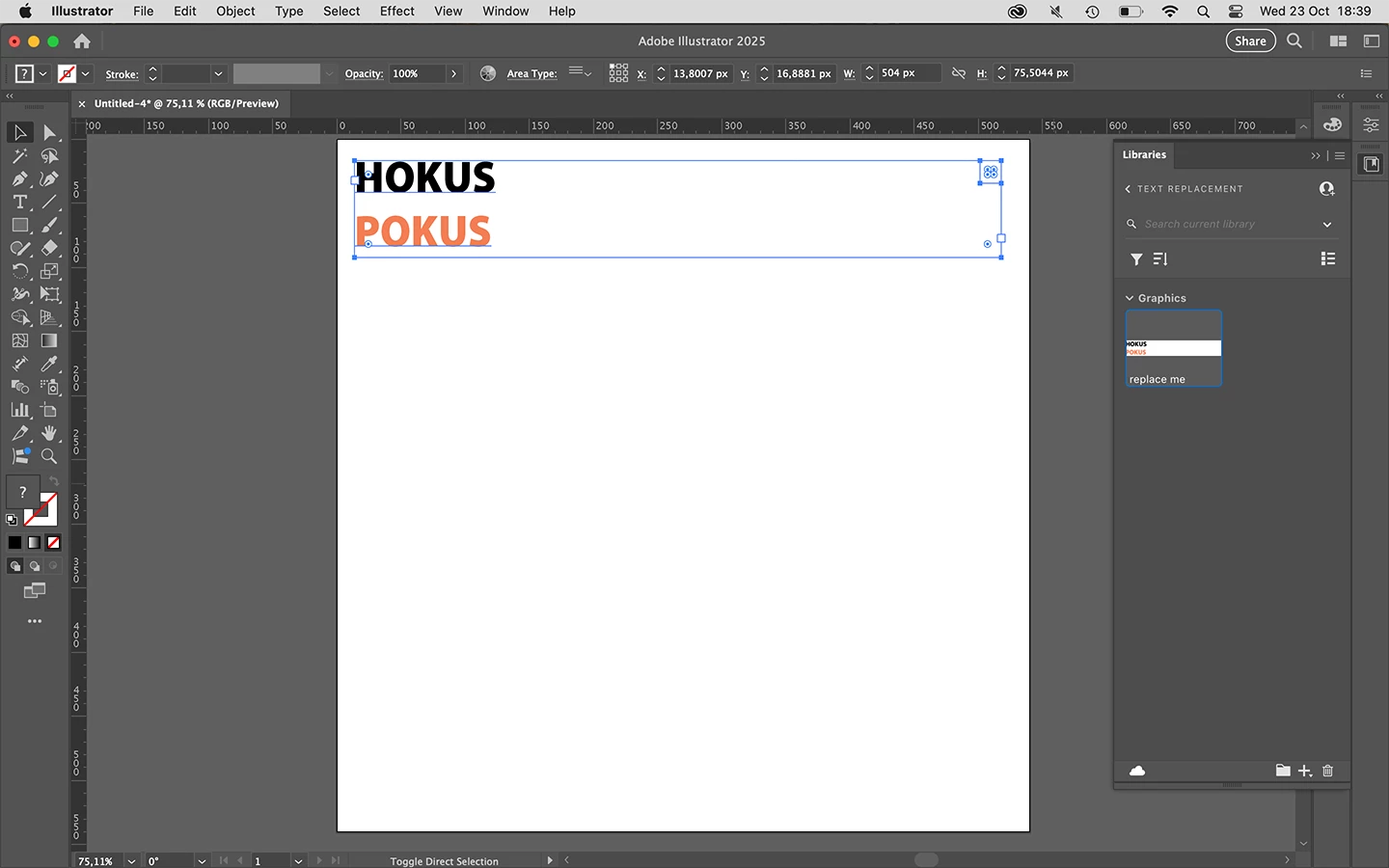

There is no standard way of linking text in Illustrator.
But you could place an Illustrator file as linked into other files and change the linked filed or use CC libraries:
Create a textframe at the maximum size you will need and add some styled text.
To avoid it being seen as text when placed, add an empty no fill/stroke object. I used an empty square at the upper right corner.
Select both and drag to a CC library.
Drag  the item from the CC library into various documents and save them.

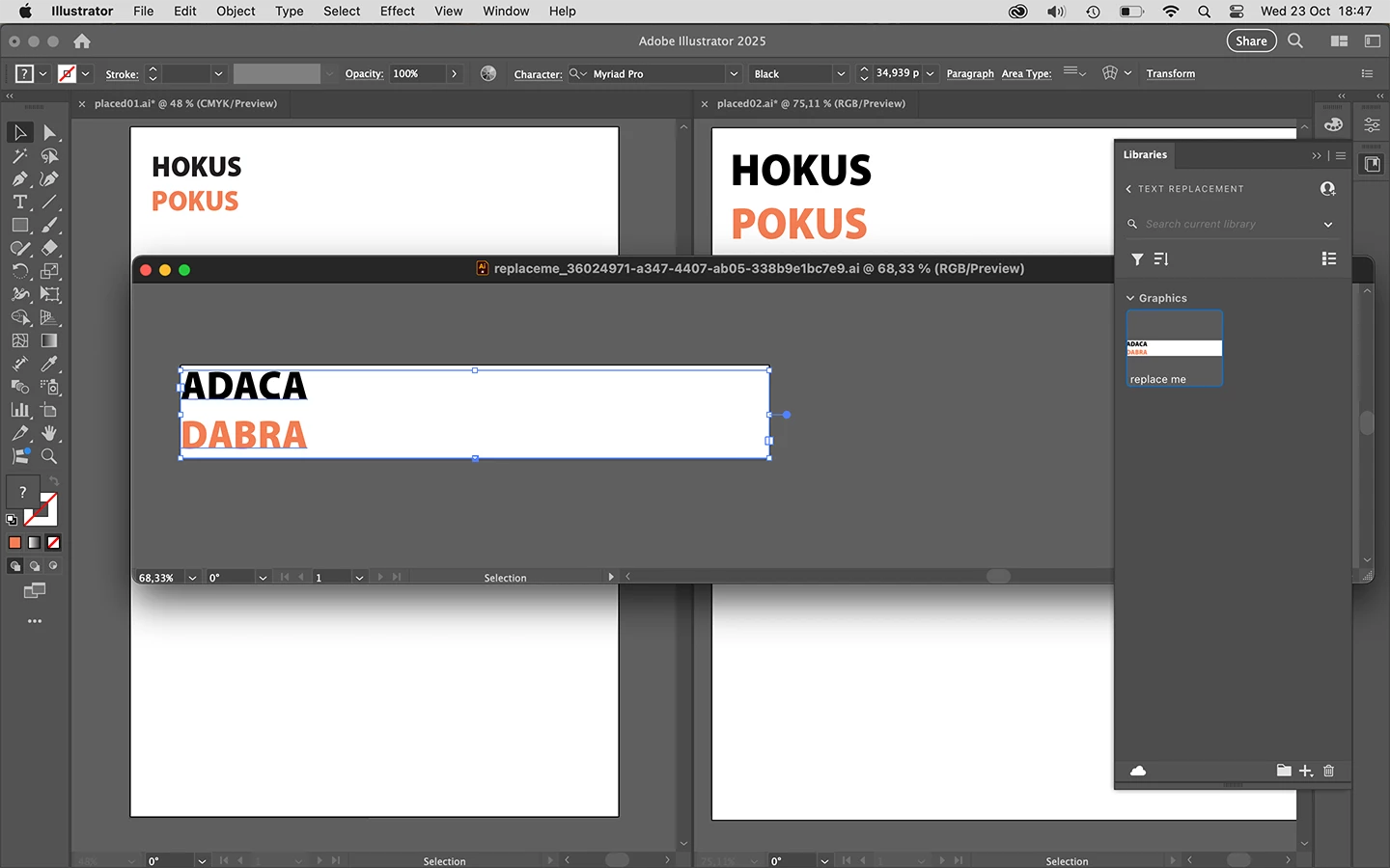

When you double click the item in the CC library you can change the text and save it.

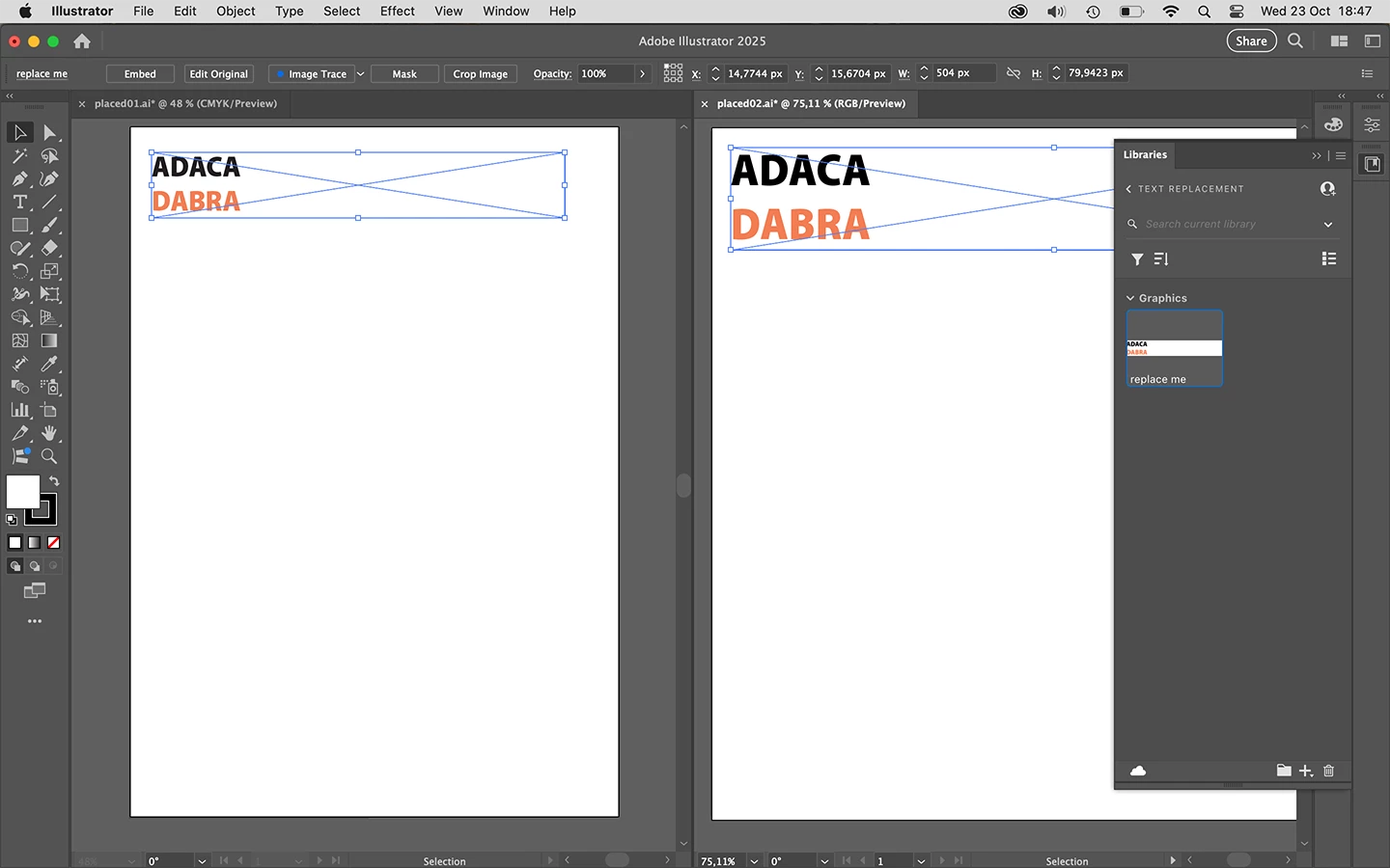

You need to update the files that contain the library item by opening them and saving them.
