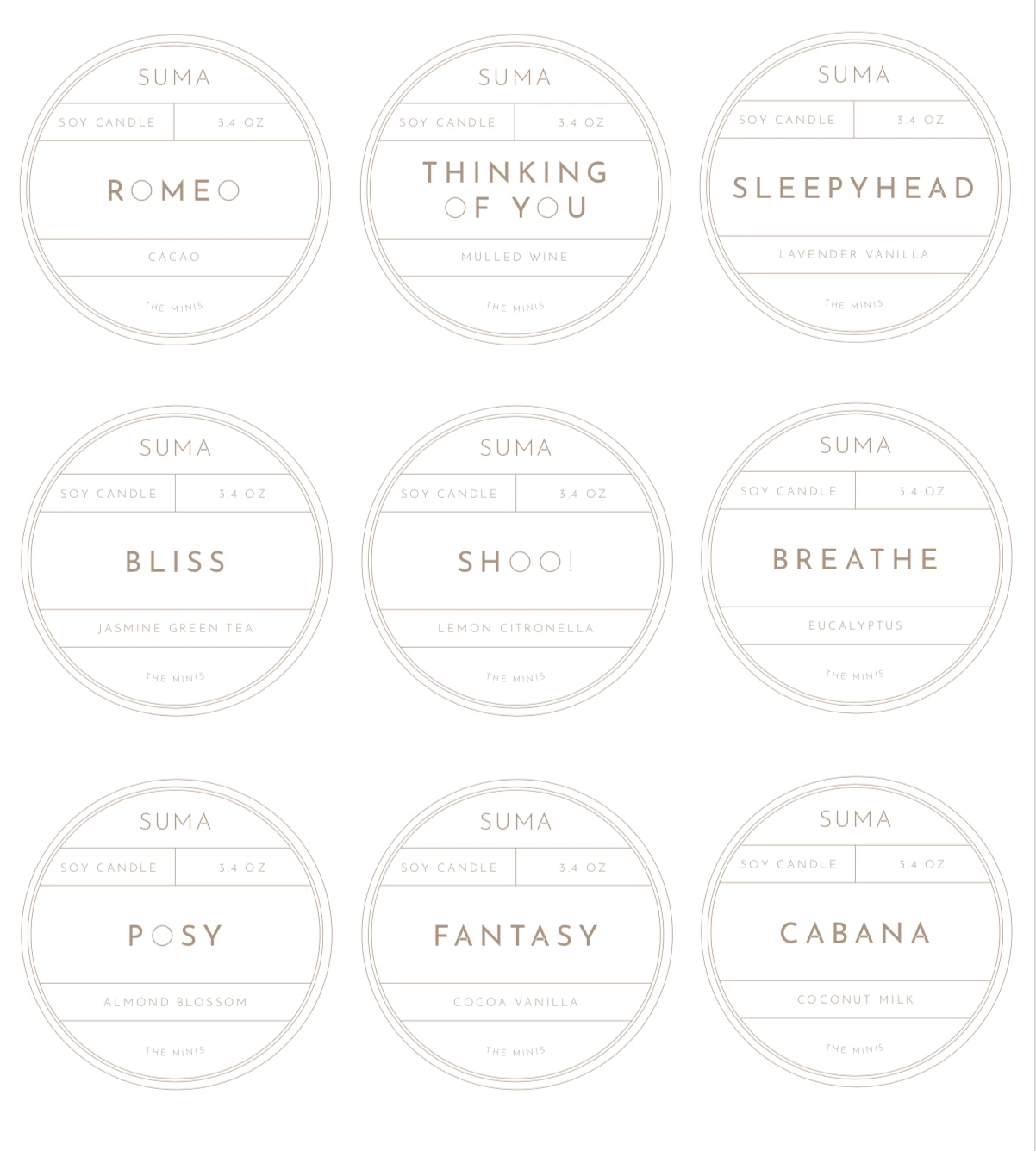

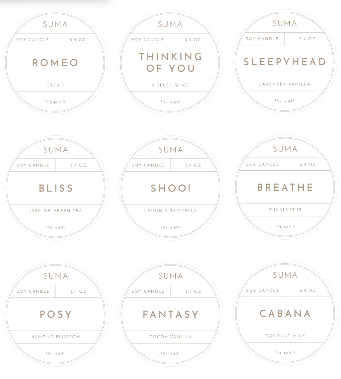

When I export my project as a PDF, the text's weight seem to be altered where some texts are bold and others are light. I have attached some photos of what the original looks like within Illustrator, and what it looks like when exported and opened on the Preview app. Is there a certain setting I need to change so that it exports well?
This is original:
This is what it looks like when exported as a PDF:

How does it look in Acrobat?
And if you outline Type?
Ton Frederiks
Ton FrederiksCommunity ExpertCorrect answer
September 14, 2020
RaachelcAuthor
September 15, 2020
Creating an outline in the type worked! Thank you!
