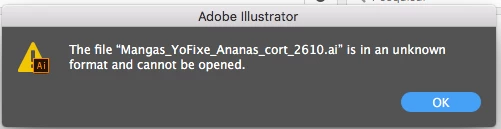

Hello
I'm having this issue when I try to open recent files from Illustrator or Acrobat.
See image:
I have a MAC OX El Capitain 10.11.6.
Can you help?
    Correct answer jamess95197238
    Hey all,
    I know I'm late to this, but it may be helpful for future problems, on a Mac at least. In Finder, go to the corrupted file, right click, "Get Info", remove the .ai file type from the name, MacOS will prompt with something like "Are you sure that you want to remove the file extension?", click yes. Then add the .ai back, you'll get another dialogue warning about changing the extension, click yes, and it should be good to go.

    And you need help with that message?
    Which version, which system?
    Where is the file stored?

    Yup, sounds like you have a corrupt file on your hands.
    Try placing it in ID.
    Export as an EPS and open in Ai.

    Placing it in InDesign is the same as placing it in Illustrator (only more complicated).
    If placing in Illustrator doesn't work, placing in ID won't either.

    Nothing really worked. We tryed everything, and nothing.

    But before I give up all hope, I'd like to have those questions answered. If only to prevent this in the future.
    Monika Gause
    August 21, 2017
    Which version of Illustrator?
    Are you working on the file on just this machine?
    Where do you save your files?
    What's in the file?
    Is it an older file?
    When did you last restart that computer?
    dianac98255847
    August 21, 2017
    Hello Monika
    Which version of Illustrator? Adobe Illustrator CC 2017
    Are you working on the file on just this machine? We can work the files on other computers equal to mine
    Where do you save your files? They are saved in a QNAP
    What's in the file? Vector/images/fonts
    Is it an older file? Recent one
    When did you last restart that computer? Today
    Monika Gause
    August 21, 2017
    You could try if one of the other computers can still open the file.
    But the network drive most probably causes the issue
    There is a known issue with Illustrator and saving to/opening from networked drives.
    Illustrator support for networks and removable media
    For some people it works, for others it doesn't.
    Also: it might work for some people, but not for others in the same building.
    A more reliable workflow would be to first copy the file from the server, then edit it and save to your harddisk, then upload to the server again.
    If no other computer can still open the file, try and work from an older backup.
    Also: try and create a new Illustrator file and place this AI file in it. But since you also can't open it in Acrobat, there's little chance this will work.
