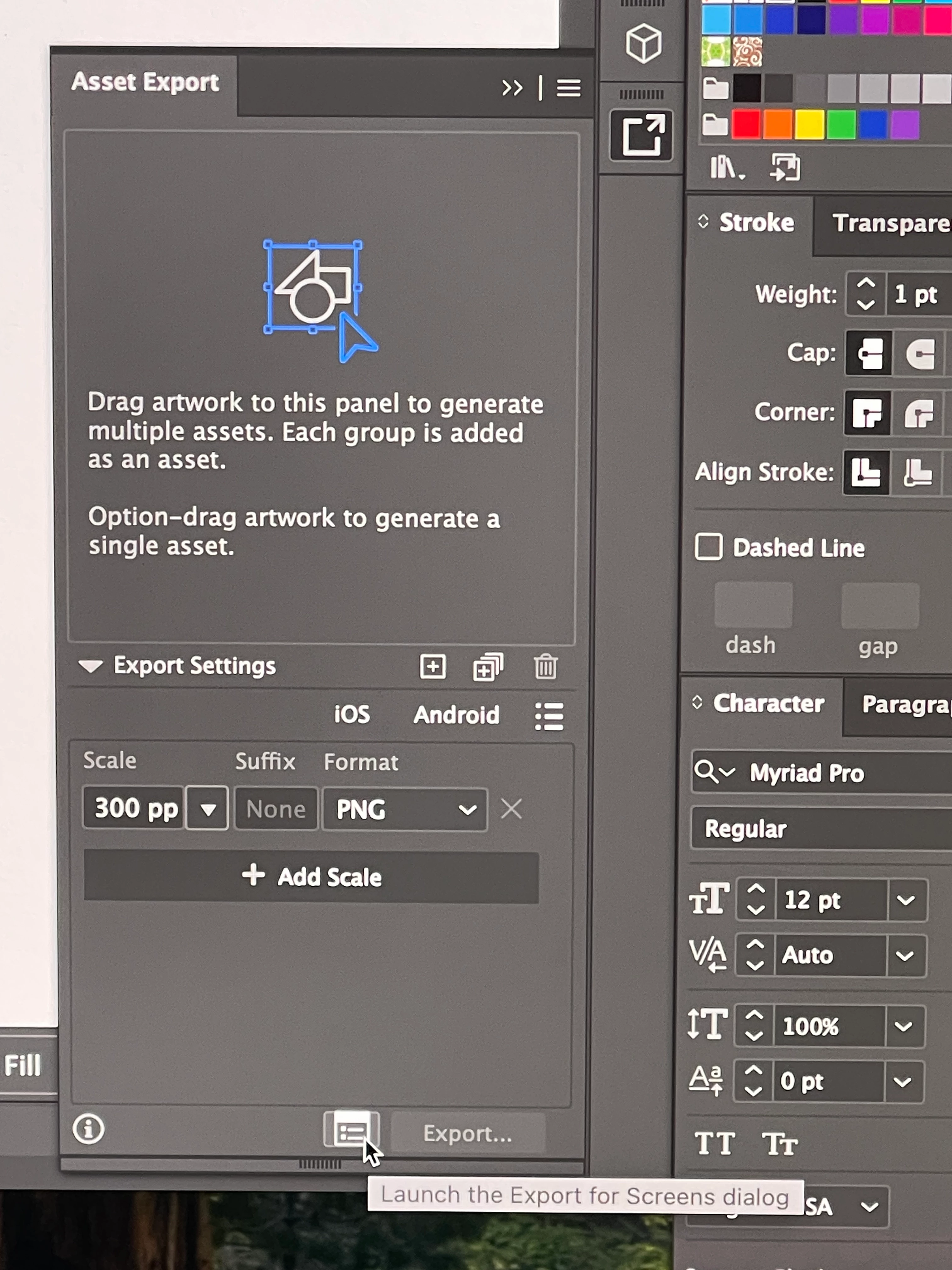

Hi @Stella5E82,
Can you please share your Asset Export settings? (button at the bottom of the asset export panel).
Keep your Document Raster Effects settings at 300 ppi. You can also try restarting Illustrator if you think it might be a glitch.
