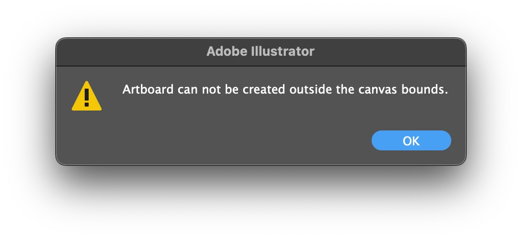

Feb 8, 2025 4:48 PM UTC
No, the canvas is not infinite, one cannot expand artboards beyond canvas. Does anyone know a way to expand canvas that is the pasteboard which is infact the grey area?

When Illustrator was first created in the 80s, it had a fixed artwork area, essentailly a large blank piece of paper to draw on (the "canvas"). Any graphic created was drawn on that work area and then exported as a file that would be just the size of that graphic (say, a logo) and nothing else. As Illustrator got better and more sophisticated, people started to need more specific layouts (like designing full pages) so the concept of Artboards was created to define, on that big canvas, a certain page size, plus you could add as many artboards of different sizes and shapes as you wanted, but this still occupied space on the overall canvas. You can see this area (which is normally* about 227inches x 227 inches) by zooming out as far as you can. e.g. here's a screen grab of a letter sized artboard in the center of the canvas limits, zoomed all the way out. "Pasteboard" is a term more connected to page layout programs like InDesign, which is the area outside your page where you can store objects graphics, etc., not used on your page, but over time, this term also came to be used to describe the open area around Artboards in Illustrator.
*I say normally since it's also possible to expand this work area in certain circumstances for extra large artwork, aka "large canvas")
