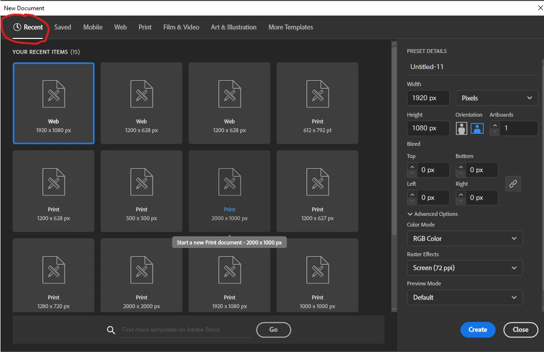

Oct 31, 2022 2:33 PM UTC
Yes
This will work on single artboard, but multi artboard it will not work this formula
Answer:
Step 1: Creat New Artboard
Step 2: In top left there have option (Recent, Web, print, etc..)
dont make in Recent. you have to choose correct one Web or Print
after you can do multi Artboard in that then export the file. It will work 100%

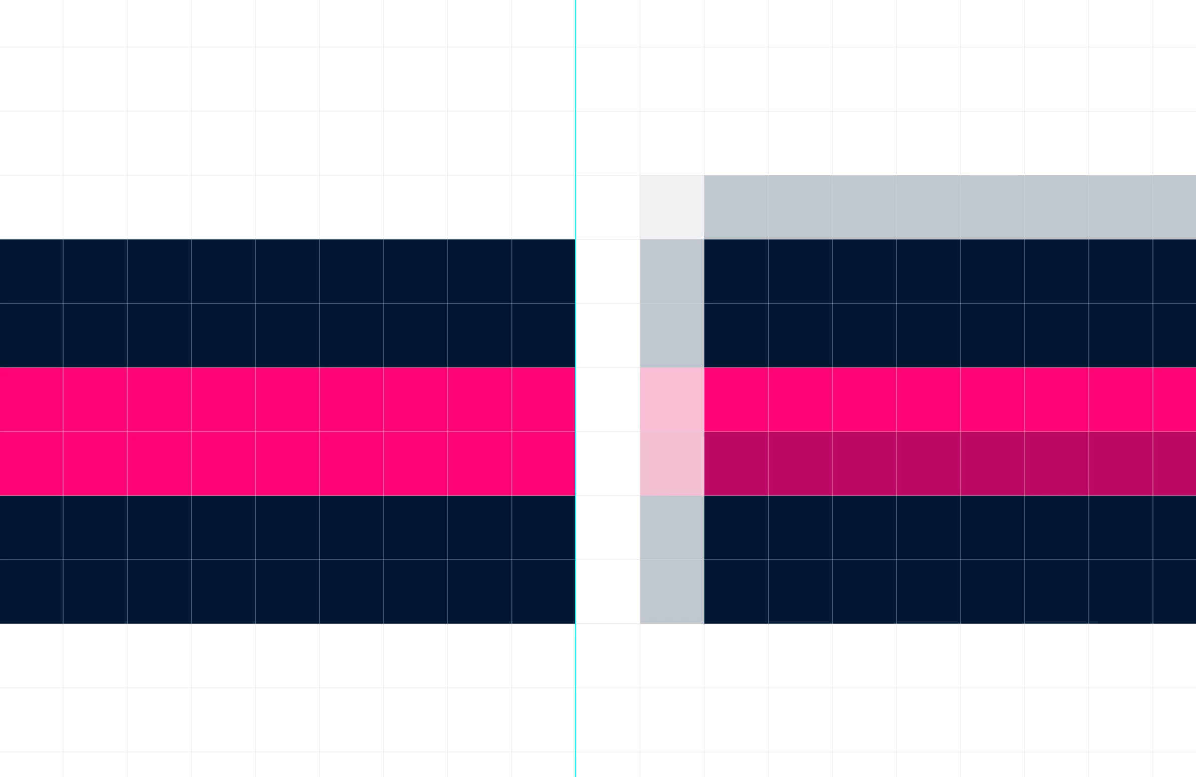

Nov 26, 2020 11:33 AM UTC
Alas, the problem persists for me even after following the steps outlined in this conversation.
  I create 3 rectangles (2 px height, 100 px length) with only fill and no stroke.  When I zoom to max to view them using pixel preview they appear as they should with no bleeding (see the LEFT side of the attached image) but when I export for screens  & bring the png back in there is overlap/ bleeding (see the RIGHT side of the attached image).
    I've set the reference points for all artwork & artboards (I have a few) to the top left and taken every step to ensure that everything in the project is pixel perfect including ensuring that all positions are in whole pixels (no fractions).
  I'm using global rulers (not artboard rulers).
  As I'm programing LED props (each pixel is 1 LED) even 1 px difference becomes a very visible problem.  Thanks for any further ideas/ solutions to this unresolved issue.
Jen
Ton Frederiks
Nov 26, 2020 12:10 PM UTC
Hi Jen, can you share an example Illustrator file?
CCfolder file sharing, Dropbox, WeTransfer, Google....
