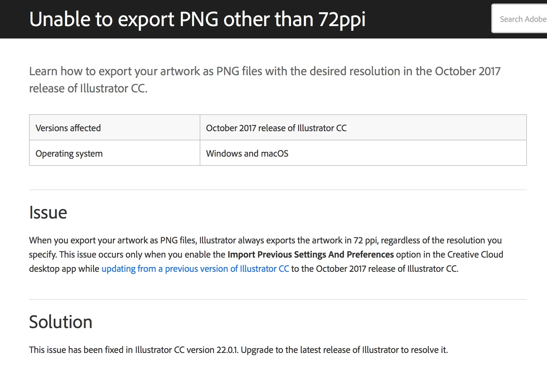

What version of Illustrator are you using? As it states there that particular problem was fixed with version 22.0.1
