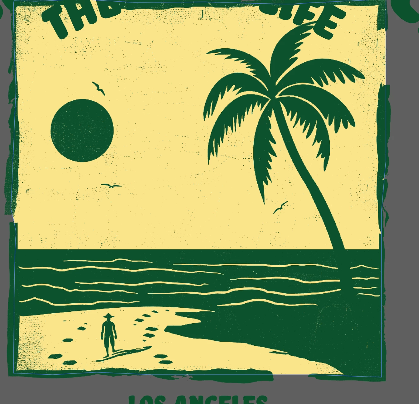

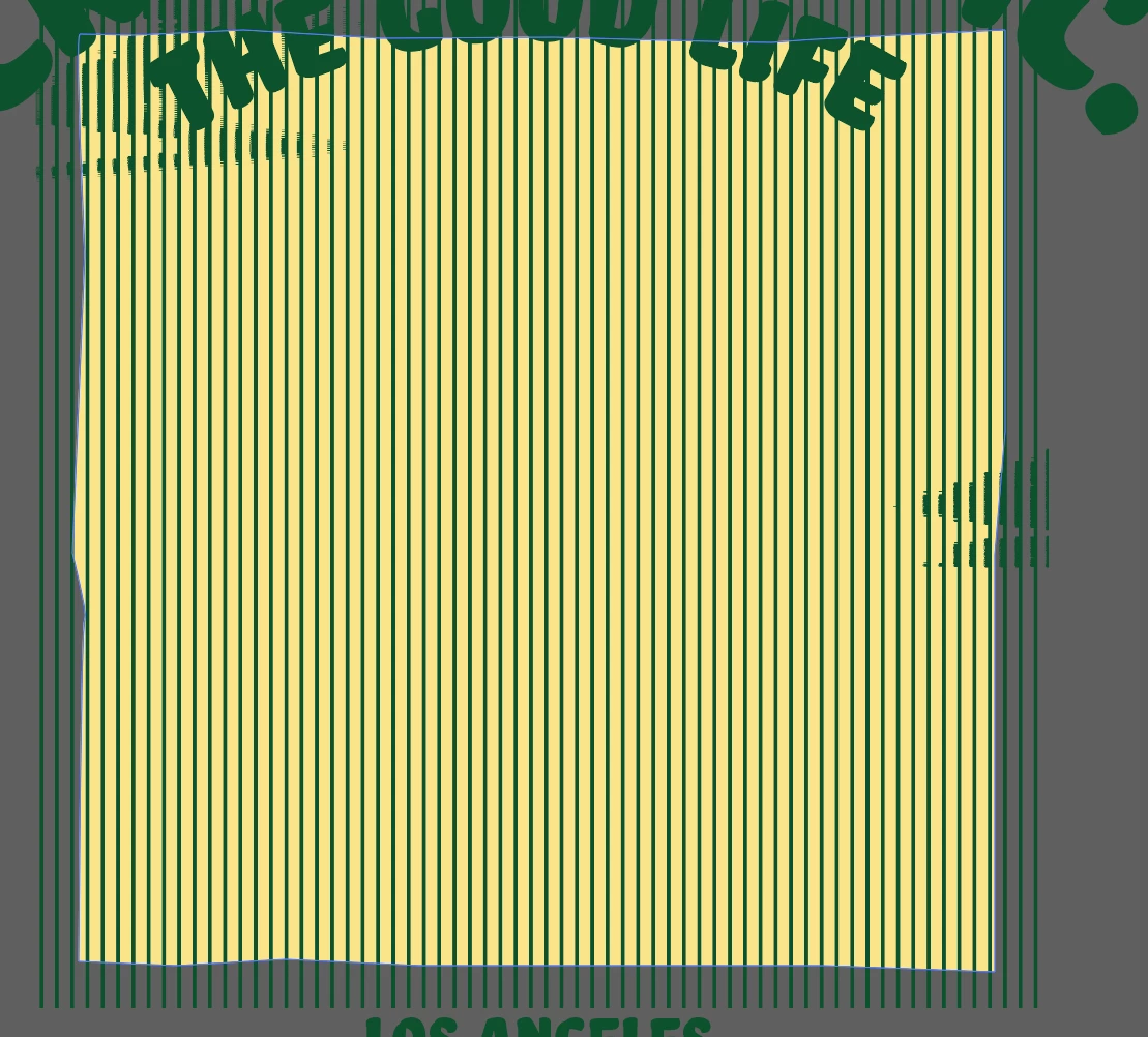

When I drop a TIFF file into illustrator and then move it around or zoom out or drag something across the page over it, it will turn into lines making it very difficult to work. Anyone else have this issue? Is there a fix? This seems like a glitch in the program, never had this issue before.
Ton Frederiks
Jul 2, 2024 12:11 AM UTC
Seems fixed in prerelease and beta versions.
Currently in 28.5, switching to GPU preview (Cmd or Ctrl E) is a workaround.

Hello @Alexander379762793e8m,
Sorry to hear about your experience. Our team has tried addressing this in Illustrator 28.6. Would you mind updating to the latest version of Illustrator (https://adobe.ly/3WihxWh) and checking if it helps?
Looking forward to hearing from you.
