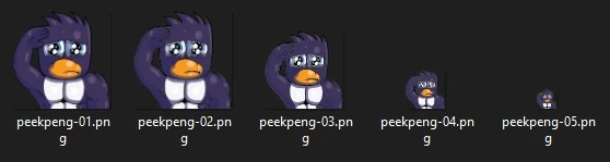

Tiny white boarder around png exports that gets worse the smaller the export is, how to fix?
I am exporting some vector illustrations as png so that it can fit the dimensions of an emoji, respectively 18x18, 36x36, 72x27, and 128x128. Every time I export them, it has a white line around it, and the smaller the emoji is the white line shows more.

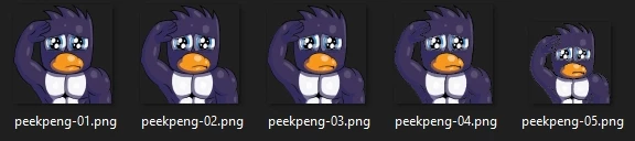

I increased the ppi from 72 to 300 and it solved the issue slightly in the exported results, but even inside of the program there is a white line that can be clearly seen.
I have attempted moving the dimensions to a whole pixel in hopes of solving the issue, but that still doesn't solve the issue I'm having.
I also noticed the problem has become worse since I switched my GPU from NVIDIA EVGA 960 (2gb of graphics RAM) to AMD Radeon 7800 XT (16gb of graphics RAM). I kept the same CPU, Intel Core i5-7600 3.50GHz, as I currently don't have the funds to upgrade it yet. I'm wondering if it maybe an issue related to my GPU, or an Illustrator problem. Or even perhaps my GPU+CPU setup causing the issue. I do remember having a similar issue on NVIDIA, but it's been awhile ago and I no longer have that GPU to test and see if it would cause the same issue.

Looks like an anti aliasing problem. Are you using Art Optimized when exporting?
Did you try to Rasterize in Illustrator?
