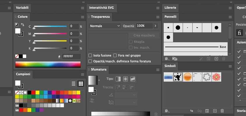

After updating to the latest OS clicking on toolbar or panels switches to Finder, as if they were transparent (click through).  This affects both Illustrator 2024 and 2023.

I'm experiencing the same problem, on both Illustrator 27 and 28, after updating to macOS 14.1.
Additionally CreativeCloud did not recognize that I had already installed Illustrator 27 which lead to not having migrated any of the preferences when installing Illustrator 28.
A workaround for the panels issue: I noticed that the panels affected are mainly the ones in top of every panel column, so I placed other (minimized) panels I never use above them. This turns the affected panels usable again.
November 7, 2023
Better workaround: don't collect all panels in one giant superpanel but make single panel columns instead. You might struggle a bit until you will have "liberated" all panels from the super one but that did the job for me. Obviously also single panels should work which would be much more annoying.
