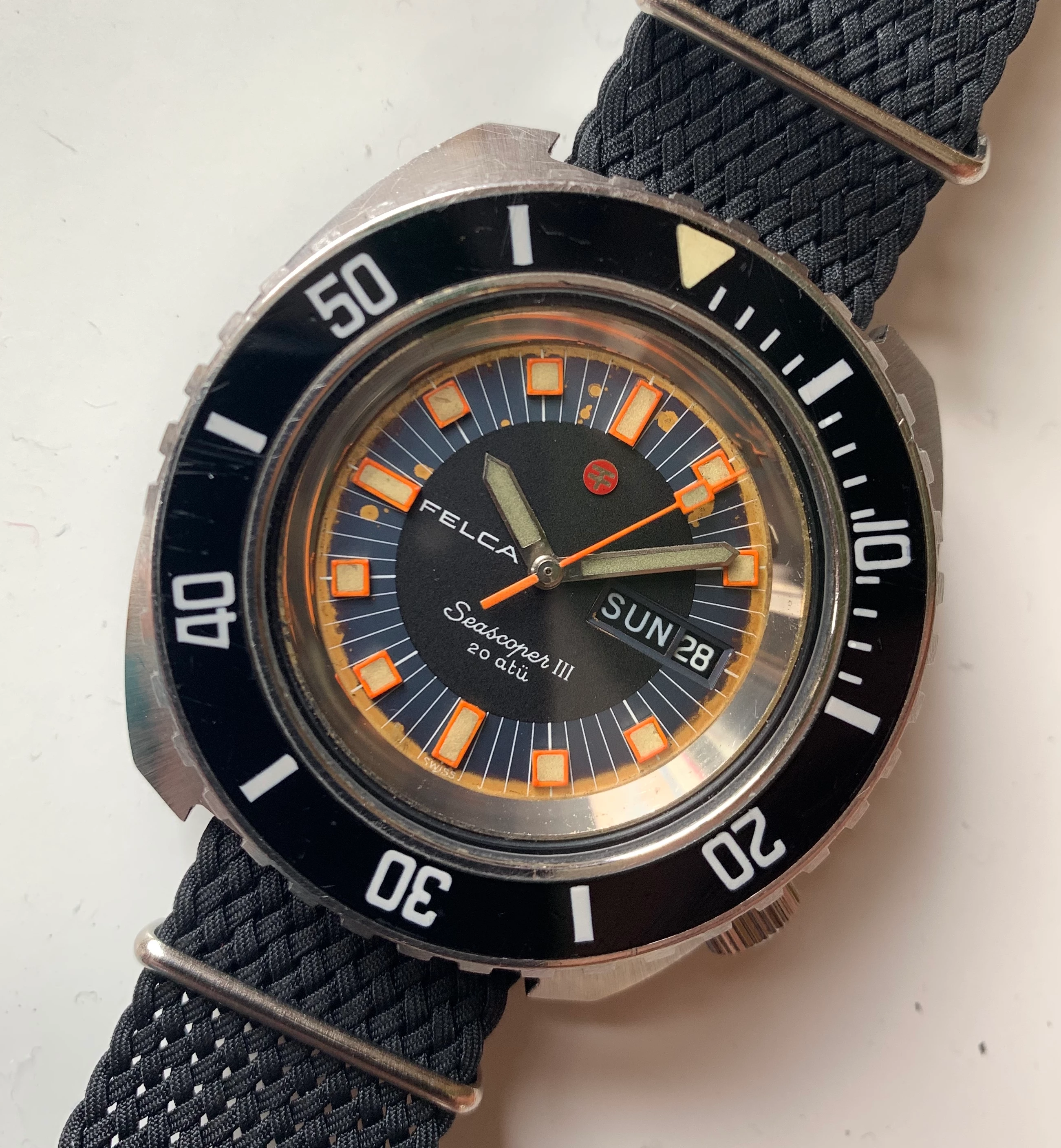

Good morning,
i'd like to obtain a vectorial image of a watch dial (attached):
- both words (FELCA) also (Seascoper III 20 atu).
- dial in white print measure 28mm
I'm able to do it in Photoshop, but how can I do using Illustrator? In that way I can export it in a laser cutting software i use without losing resolution.

The Image Trace panel does the autotrace. But I don't think you will get good quylity with it. You might need to do this manually.

i'd use the pen tool and do it manually. How can I export only the path later?
Do you have any suggestion for the notches of minutes? I'd like to draw them with a pattern command.
