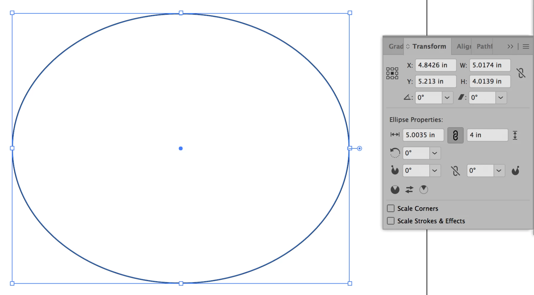

This is driving me a little nuts and I don't know why this issue is happening for me in 24.0.1 version. If I change a square shape dimension by using the transform panel and plugging in 5in. x 3 in., upon hitting the enter key to commit the value, it changes it to 4.9953in x 2.993 in. Why is it not keeping the 5 x 3 values that I keyed in? I have to type it in at least 3 times in a row before it sticks.

    This usually happens when "Use Preview Bounds" as well as "Scale strokes & effects" is turned on in the preferences and you type the values in the W and H fields instead of the shape properties.

    "Scale Strokes & Effects" is unchecked  in the shown screenshot

    With the inconsistencies and the actual figures, it might point to something from the list (which includes preferences deletion/replacement), but what happens if you set the X and W to integer values and then (re)set the Width in the Ellipse Properties to 5?
    And, forgive me for asking, are you sure there is no way you are aligning to you know what (4.0139" is an inch a a point)?
    Concerning the latter question, it would fail to fit with the Y value.
    The ratio of the actual W and H values is 5:4, so there seems to be a slight upscaling (which is inconsistent with the Ellipse Property values).

    Here is an example where I typed in 5 x 4 on this ellipse, notice that not only are there decimals after them, but then in the properties panel those measurements are off.
