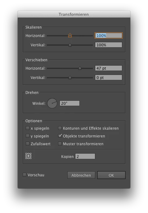

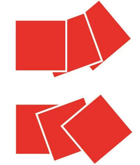

Ok, this shows my problem. First: Filter, second: js. Below window of the filter and the relevant part of the script.

You rotate and transform the new (translated and rotated) copy of the original object. Since the x translation is the same, your objects appear spaced out at 47 pt horizontally; the y translation stays the same, so the object does not move vertically.
The rotation, on the other hand, gets applied incrementally -- the first copy is rotated by 20°, the second by 40°.
The Transform Filter also rotates both the x and y translations by the same angle, so the original object moves 'up, up and away'.
I ran into some problems trying the same with each next duplicate, so instead I do each translation-and-rotation on the original object (I'm sure it's just a question of maths to get that right, but in this case it's virtually of no importance since the end result is the same). I increase the angle of rotation and concatenate the Verschiebung with its previous value. Voila: the same result.
(A difference is that I tested with CS4, and in that the Transform effect dialog still has the nine-point rotation origin proxy. In your version -- CS6 -- it's strangely missing.)
