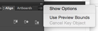

    You can also quickly get to Use Preview Bounds setting for he align palette fly out.
