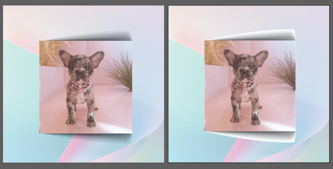

Hi everyone,

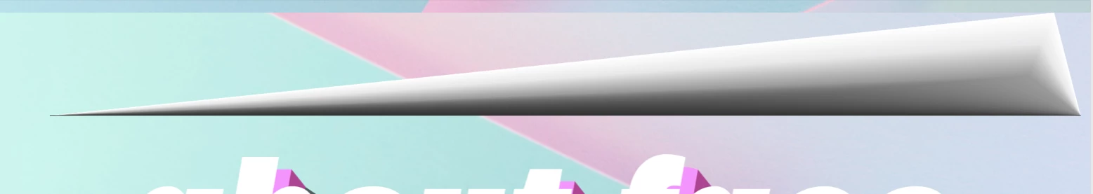

I'm working on a website for a client and I'm experimenting with transparency and shadow effects for the first time. We've incorporated these "paper cut" effects throughout the website, but the effect isn't the same when I export as a PNG. The below screenshot is essentially what the effect should look like on a solid color background or white/transparent.
Now the idea is to have these "paper cuts" attached to a photo that floats over the parallax background on the website. Something like below. In this particular example, the two paper cut shadows would be grouped with the photo of the puppy and exported as one PNG.

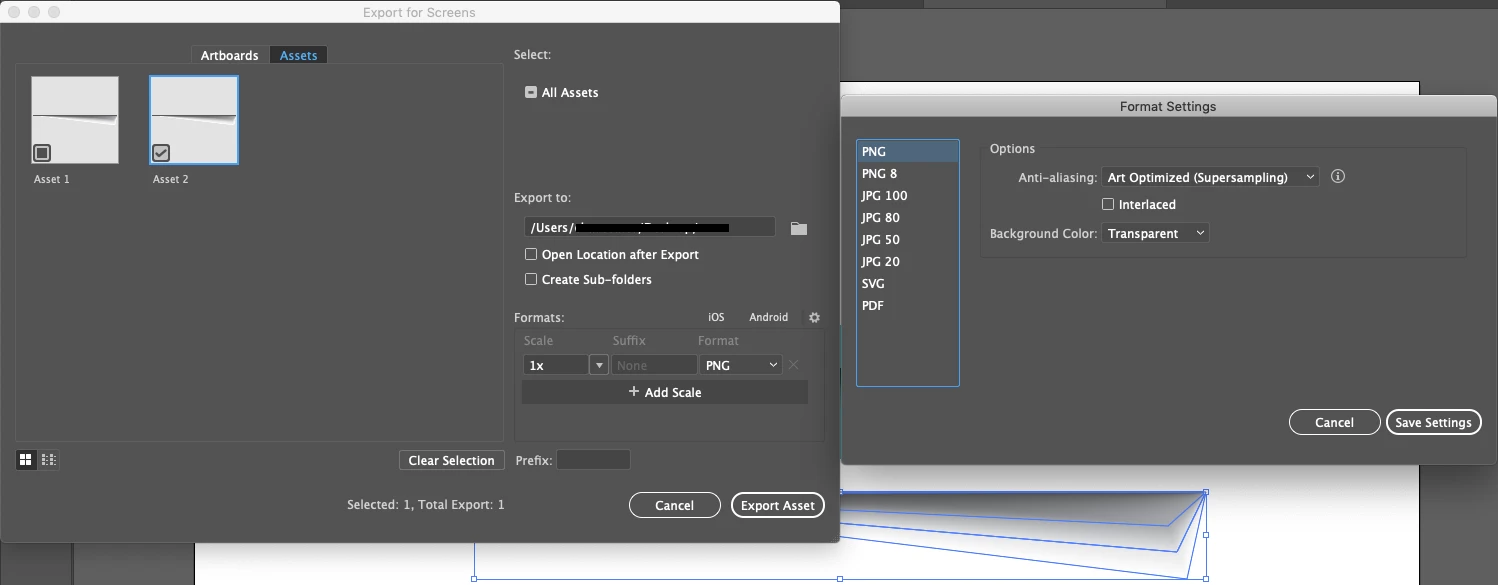

Here is a shot of my export settings:

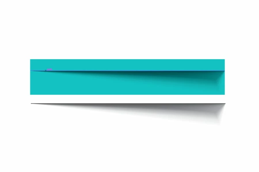

And here is the result:
I'm hoping that it's a simple fix and I just need to adjust colors or something. I've exhausted my resources and I need some help from you guys.
Thanks in advance! I'd be happy to offer up any more information if needed.
Working in CC on MacBook Pro Mojave 10.14.3

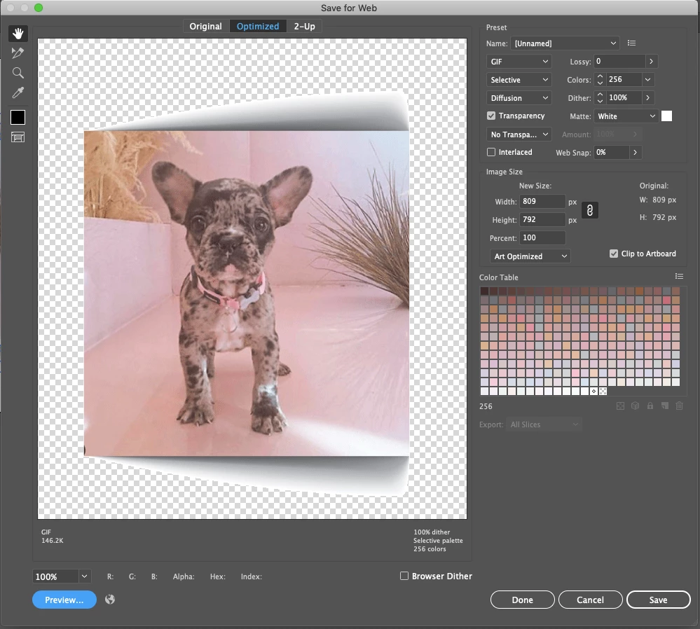

Hi yes use save for web option for saving this then hope you get your problem fixed...Thanks

Hi lambiloon. Thanks for your reply.
I used the Save For Web option with the below settings.
The results were the same as grouping the objects and exporting to PNG. The left artboard is the original artwork (shadow 1, picture, shadow 2 on 1 layer) and the right artboard is the result.
Do I need to change something in the settings for this option to work?
Kenneth Kawamoto
March 12, 2019
Can you try exporting to PNG-24 with Transparency instead of GIF?

Monika Gause
March 12, 2019
But your screenshot doesn't show the shadow with the image in the export dialog box.
