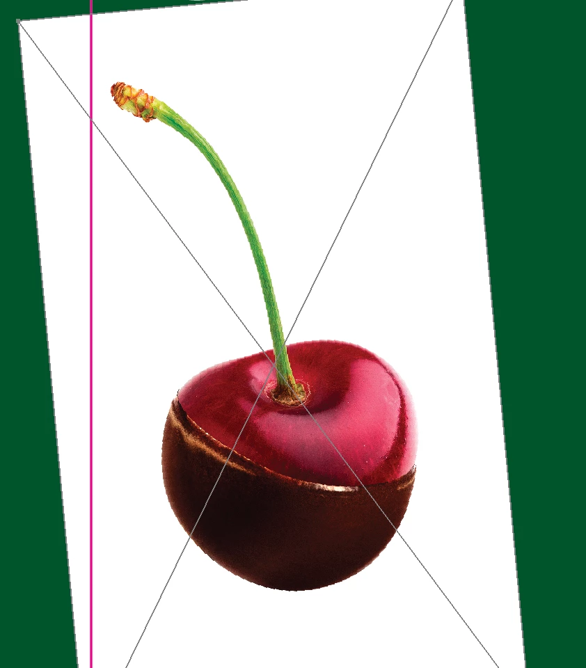

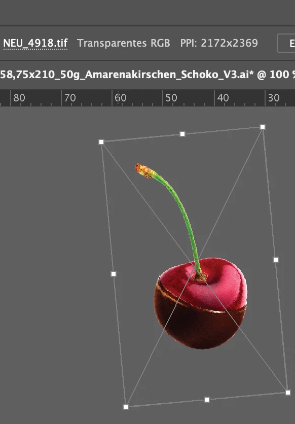

Hey there 🙂 I designed a layout in illustrator and added photos as transparent tif files. If I move them on the artboard, they all of a sudden have a white background, which is not in the tif file. The white background also appears when exporting the PDF higher than X-3 / compatibility 1.3. If I move the image outside of the artboard or copy it to another file, it looks just fine, transparent, no white background. Any clue why that is and how I can get rid of it?

we use the die form ai file we got from the printer and added our design in there. the images are also added separately, as tif images. as written in another comment above, it happens with all image formats.

It happens with the tif we used so far, but also with psd and png files, we tried all formats. Same result.

Hey there! thanks for your speedy reply. I thought so too, but exporting it with 1.3 the PDF looks fine. Exporting it higher, and our printer requires a minimum 1.7 compatibility, makes the white boxes appear in the print PDF.
As for illustrator: There I am using the latest version too. Any clue how to get rid of it? 🙂
