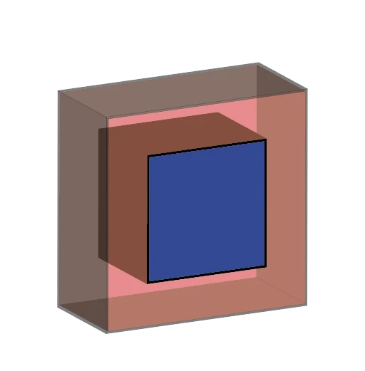

Then I extrude them using the 3D effect. This is what I see on my Illustrator workspace (and what I want to achieve):
The two object are well placed and the different superposition of the 3D is respected.

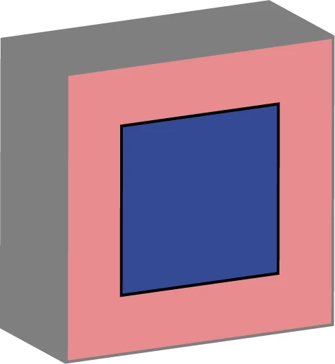

Then I export them into a PNG file and this is what I end up with:
The transparency isn't present anymore and all the superposition are reduced to a uniform color.

    Did you check Draw Hidden Faces in the More options for the 3D effect?

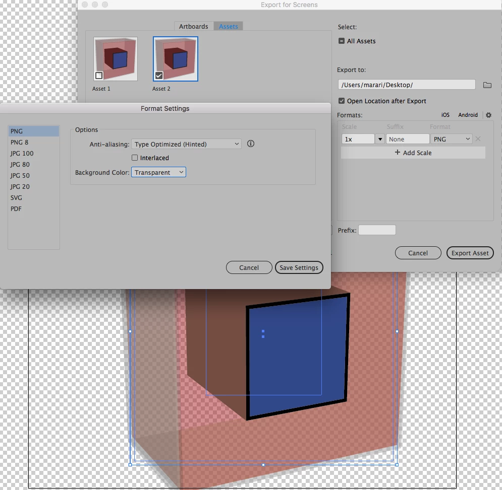

    April 11, 2019
    Try this
    1. Select your 3d object
    2. Go to File, Export selection
    3. Click on the little gear and under the background color choose Transparent and save settings
    4 Export asset
    5. Done, your file must be transparent
