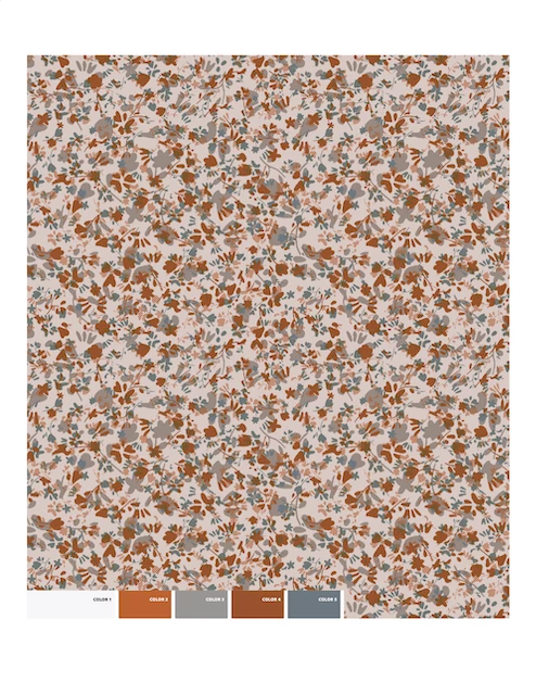

I am having an issue with the transparency masks in illustrator.

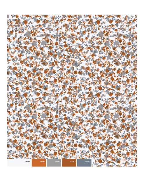

I have made a pattern in illustrator and I am using boxes with layer masks to cutout a bitmap design. When I am editing in illustrator everything looks correct. I am able to print, and it prints correctly. Here is the thumbnail of what it looks like in illustrator:

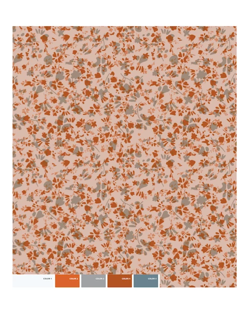

The background is white as it should be and each color is displaying as expected. The issue happens when I these files outside of illustrator. I have 2 thumbnails, and the first one shows how it displays in preview (I am on a mac). The other is uploaded to sharepoint and viewed on there. They both show incorrect colors.
Both PDF and AI file display like this. I have tried various different ways of exporting the pdf and it does the same. I have also made other designs like this before, and they all will show different visual errors. Sometimes it won't even show any layers. I also know the file isn't damaged, because when I open the pdf in illustrator it displays correctly.
The pdf is attached, so check it out yourselves. It may not do this on a PC. I haven't checked.
Here is the link to the AI file.
https://drive.google.com/file/d/1yaoloL1TKuZgJPhi5Fp7JIwvLTSPULOk/view?usp=sharing
It wouldn't let me upload it on here. Some postscript error that's worth another post to figure out. Here's the error "Correct the highlighted errors and try again. The attachment's testprint.ai content type (application/postscript) does not match its file extension and has been removed."
Thank You all!

Part of the issue is that your docuemnt is currently in CMYK mode, and your pattern is made up of a complicated layer sandwich of masked colours set to "Darken" over top the layer beneath it. these are mix modes best left to RGB and have weird results in CMYK, as you've discovered especially in non-Acrobat viewers.
Either change your document colour mode back to RGB; this immediately solves the issue, then if you're doing an actual CMYK print, let that happen at RIP stage (or render the file into Photoshop).

As Monika mentioned Apple Preview does not support all PDF features (and the PDF part is what is previewed).
