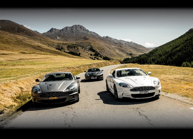

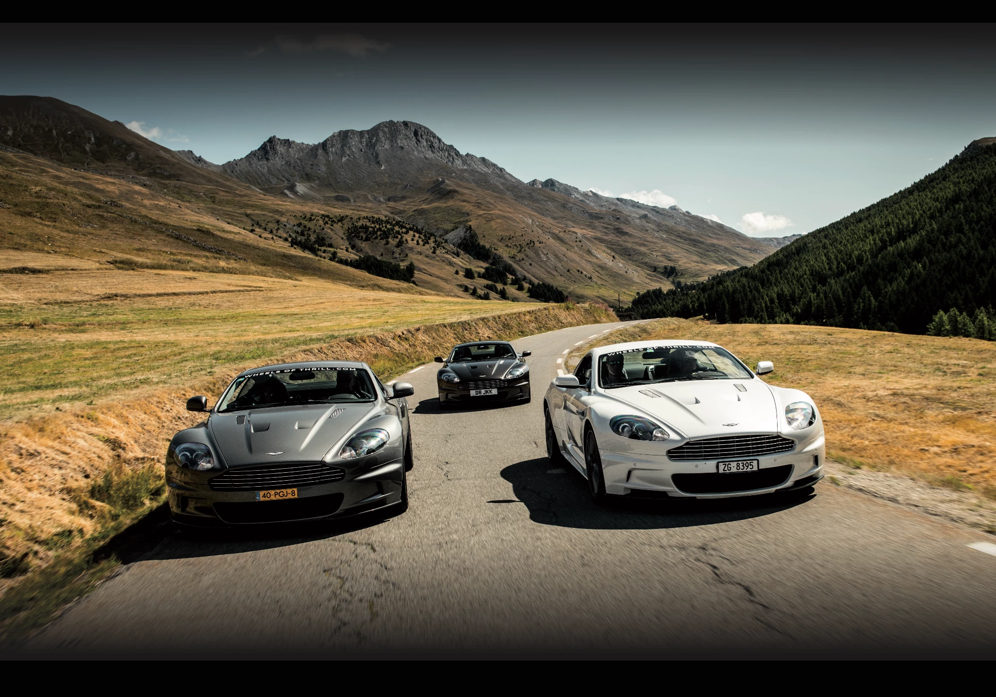

I am making a roll-up banner with a black background and a picture in it. The idea is to fade from the black background to the picture, and then back to black again. I overlaid the picture with a rectangle at both top edge and bottom edge of the picture. Both rectangles have a gradient that fades from 0% transparency (black) to 100% transparency (pure image). This looks great in Illustrator, but the exported PDF clearly shows 'hard' top and bottom edges of the picture. See screenshots of Illustrator and exported PDF attached. Does anyone know how to solve this issue?

I tried flattening, but this didn't do the job sadly. However, I looked at the older files in which I succeeded to do this, and found out that these were saved as PDF X-3 instead of X-4. Although X-4 is preferred now by the printshop, I managed to get the desired result by saving as PDF X-3 in which flattening could be performed during saving. For some reason, I can't get this to work in PDF X-4. The flattening option is disabled, and flattening myself before saving doesn't work apparently. Although the problem is solved now (I just uploaded the files as PDF X-3), I am still wondering what the difference is and why this occurs.

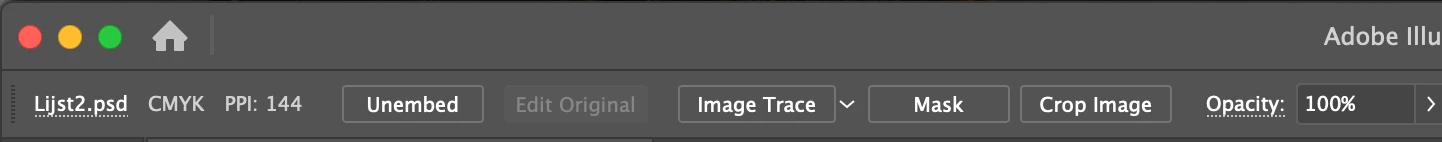

Yes the document is CMYK, the picture was RGB but upon loading it asked me transform to CMYK. Linked or embedded I have no idea what you mean, I copy/pasted the picture into Illustrator.
Ton Frederiks
Aug 12, 2024 11:26 AM UTC
Thanks for the info. If an image is linked, it is not included in the Illustrator file, but referenced outside the document. When embedded, the entire image is part of the Illustrator file.
You can see if an image is linked/embedded in the Control panel and the Links panel.

And those are not the edges of the photo?
I can't see it in your screenshots, sorry.
Aug 12, 2024 10:57 AM UTC
Sorry for not including a bit of more background on the top and bottom edge, but in one screenshot you clearly see a 'faded' transition from the picture to the black background (illustrator file), while in the resulting PDF you see a bit of fade but still a 'hard' transition from the end of the picture to the black background.
