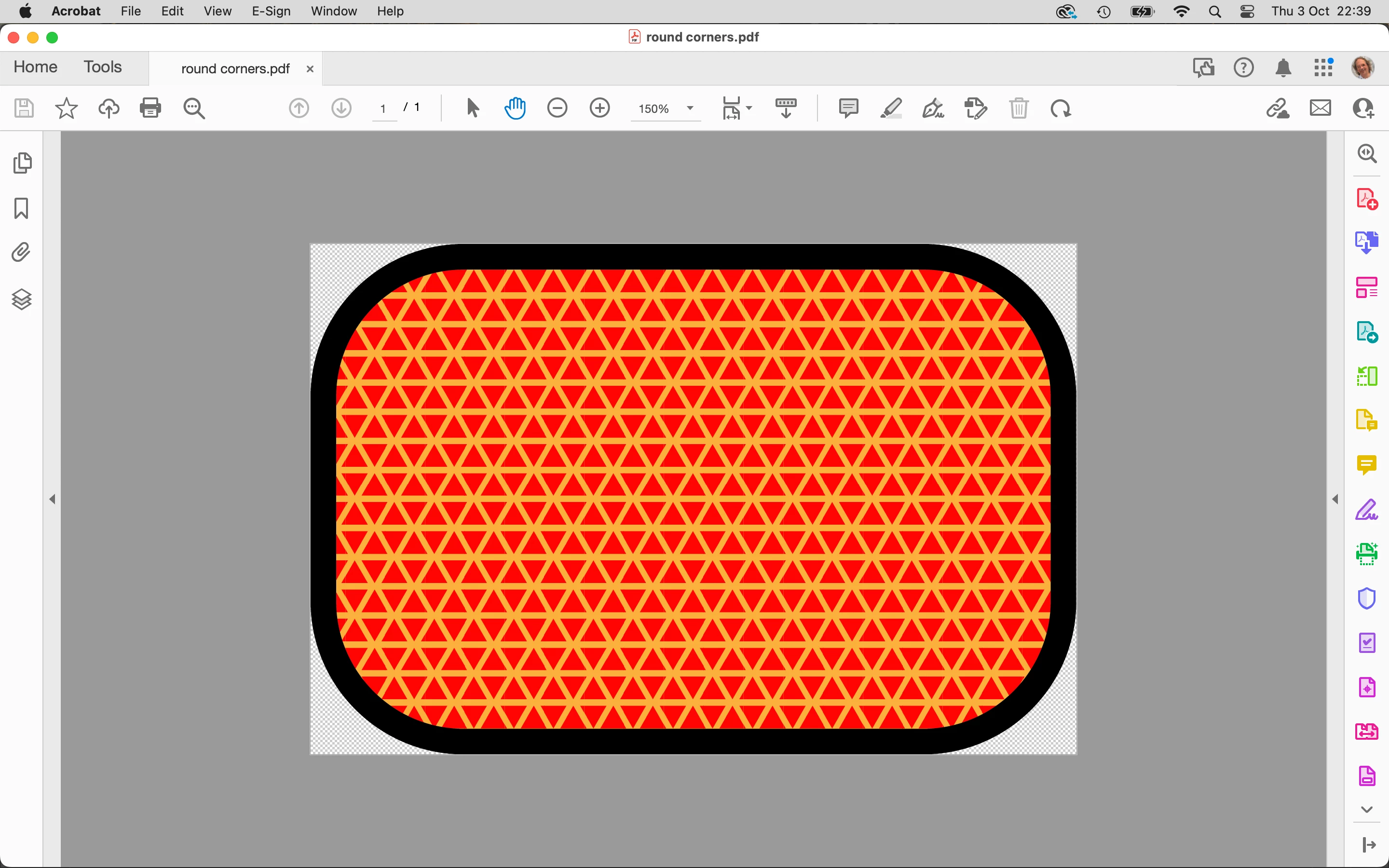

    The PDF does not have white in the corner (unless you added a white recangle in Illustrator as background).
    In Illustrator: View > Show Transparency Grid
    In Acrobat: Preferences > Page Display > Show Transparency Grid
    Try it out by placing the PDF in Illustrator on a colored background.

    The art will eventually be printed, and it is just the presence of those white corners when exported as a PDF that I am slightly worried about, in the case that the printers mistakenly keep those corners. In PNG form, obviously the corners are completely not there, and I have the path formed in the rounded rectangle shape, not in the shape of the artboard, but I don't want the printers to see the white corners in the PDF and ignore the path given for the rounded rectangle.

    Will they be just not printed on a rectangle paper?
    Or should they be cut?
    Paper white will not be printed anyway. No matter if there is an object or not.
    ANd if you want them to cut the paper then you need a cutline.
    Monika Gause
    Oct 3, 2024 9:02 AM UTC
    If this is going to be printed, then you need to provide a path that is used for cutting. Ask the printer how they need this to be (color and other attributes).
