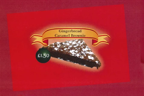

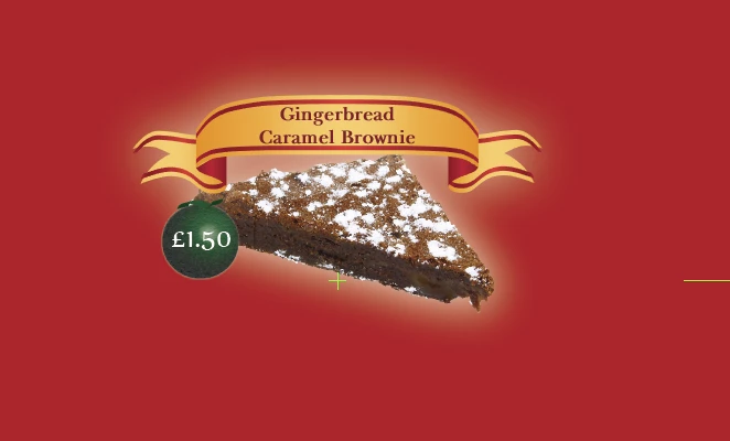

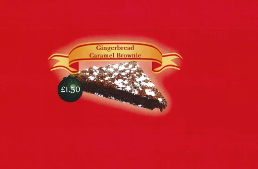

Having got a moment to call my own, I decided to upload some examples of what I'm doing:
1. This is the artwork - screenshot straight from Illy.
2. This is the scan of the default print.
3. This is a scan of the print, printed with the "Print as bitmap" option checked.
Print as bitmap and the "Raster" print option in the print preferences are the only options i can find that make a difference to the way it prints.  Hope these help to show what I'm seeing.
Glad of any comments
Regards, aTomician
