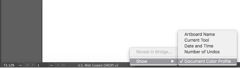

also check if bought documents are using the same profile, go to the lowest part of Illustrator and click on the little
