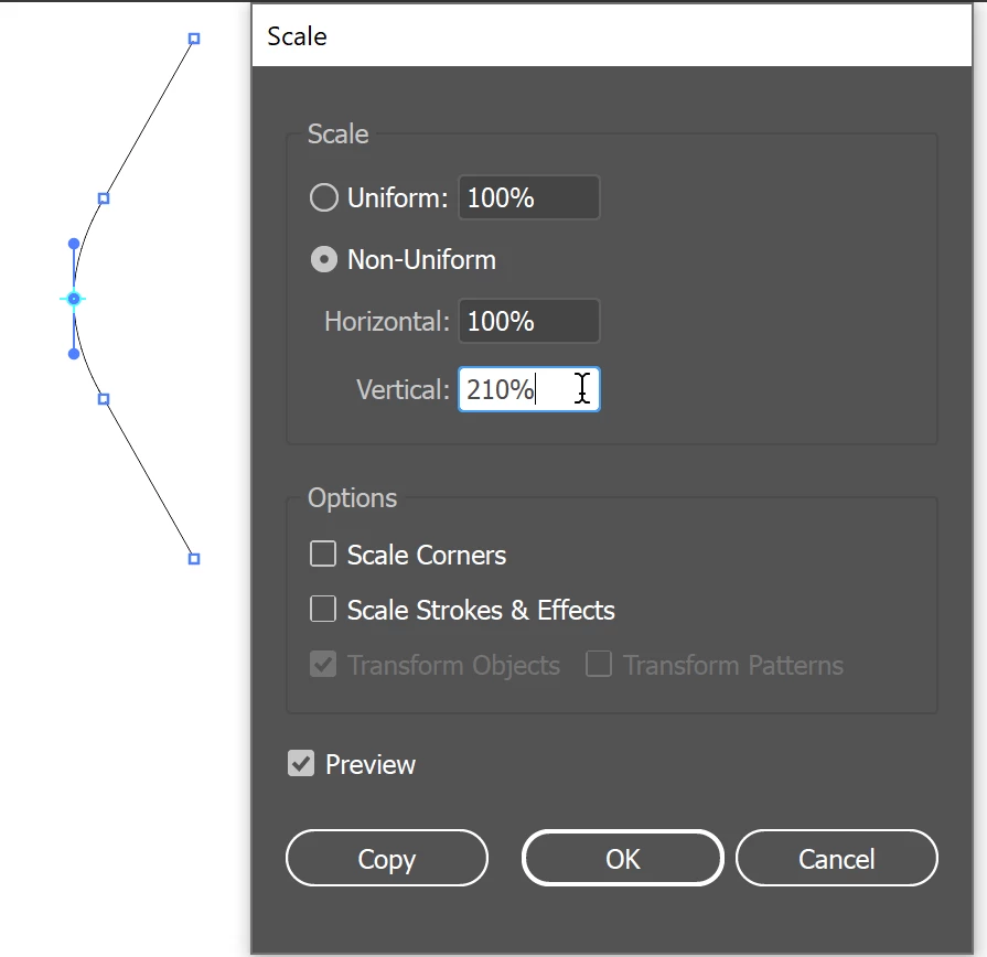

To make the center more rounded, keep the center anchor point selected and double-click the Scale tool in the Tools panel.
Increase the Vertical percentage.

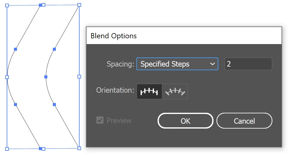

Select both lines with the black Selection tool. Choose Object > Blend > Blend Options, and select Specified Steps: 2.
Then select Object > Blend > Make.

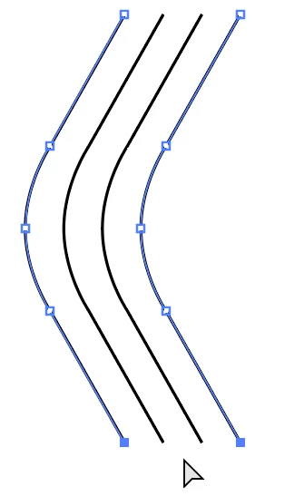

Select the blended shapes with the black Selection tool. Choose Object > Blend > Expand.

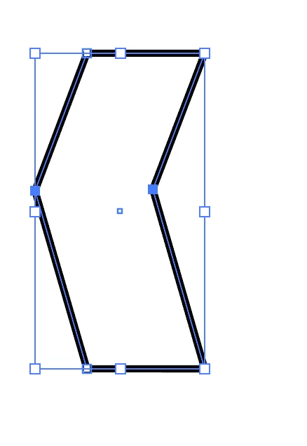

Personally, I would start with a rectangle and add two anchor points with the pent tool:
Then I woule use the direct select tool and move them:
 Then convert to a smooth anchor point:
