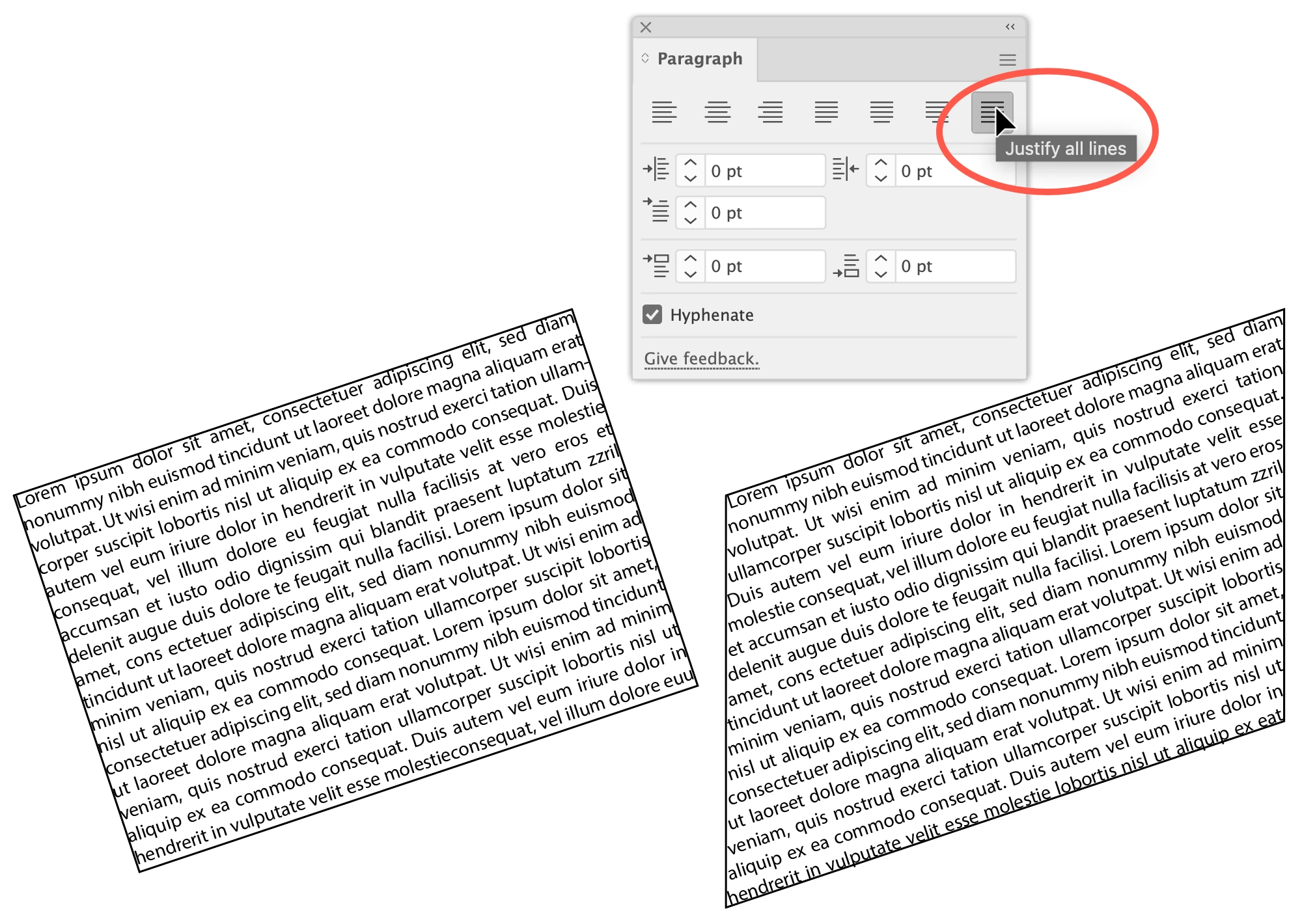

Maybe something like this?

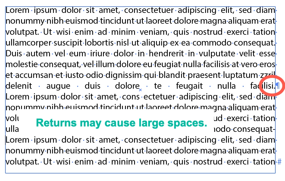

Set the text you want as area type. Go to the Paragraph panel (Window menu > Type > Paragraph) and set it to Justify all lines. You may want to remove any returns.
Rotate the type object using the Rotate Tool, Transform panel, or Free Transform tool, but not the Selection tool, which will rotate the box but not the type. Reshape the object using the Direct Selection tool.
