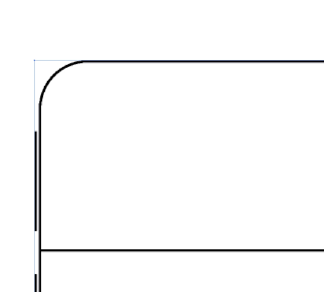

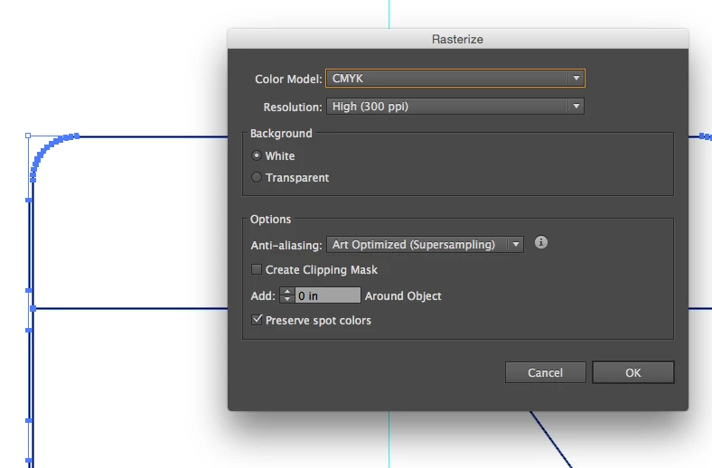

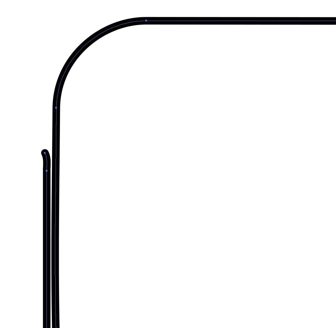

    I know that this topic is very old and most likely abandoned but I ran across this thread when trying to figure out how to do something very similar to what (I believe) D.Cloud originally asked.
    I have a bunch of old packaging templates where the stroked template lines had been converted to compound paths. I need these to now just be single stroked lines (paths) again. I believe that this is essentially what the original question was asking for.
    I found a solution that more or less works and may work for anyone else that may run across a similar need. It is not perfect  but comes pretty close.
    Here I have an image of a section of the template. It is a section of a larger compound path.
    If you take this selected object and rasterize it
    You can then do a Live Trace with the "Line Art" option
    And then "expand" this
    You then get a bunch of stroked paths.
    This may not be perfect from a CAD or engineering standpoint but it definitely gives you something that you can edit and get to that perfect point.
    I hope that someone finds this useful.

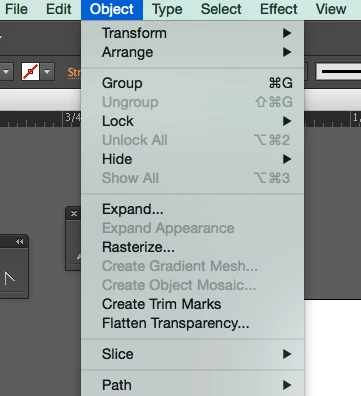

    Further to this if you want to ensure your strokes are the same width etc when you scale or shrink them you should use (with object/paths) selected Object> Path>Outline Stroke....
    This is particularly important if you are placing a native illustrator file where no pre rastering etc has occurred..

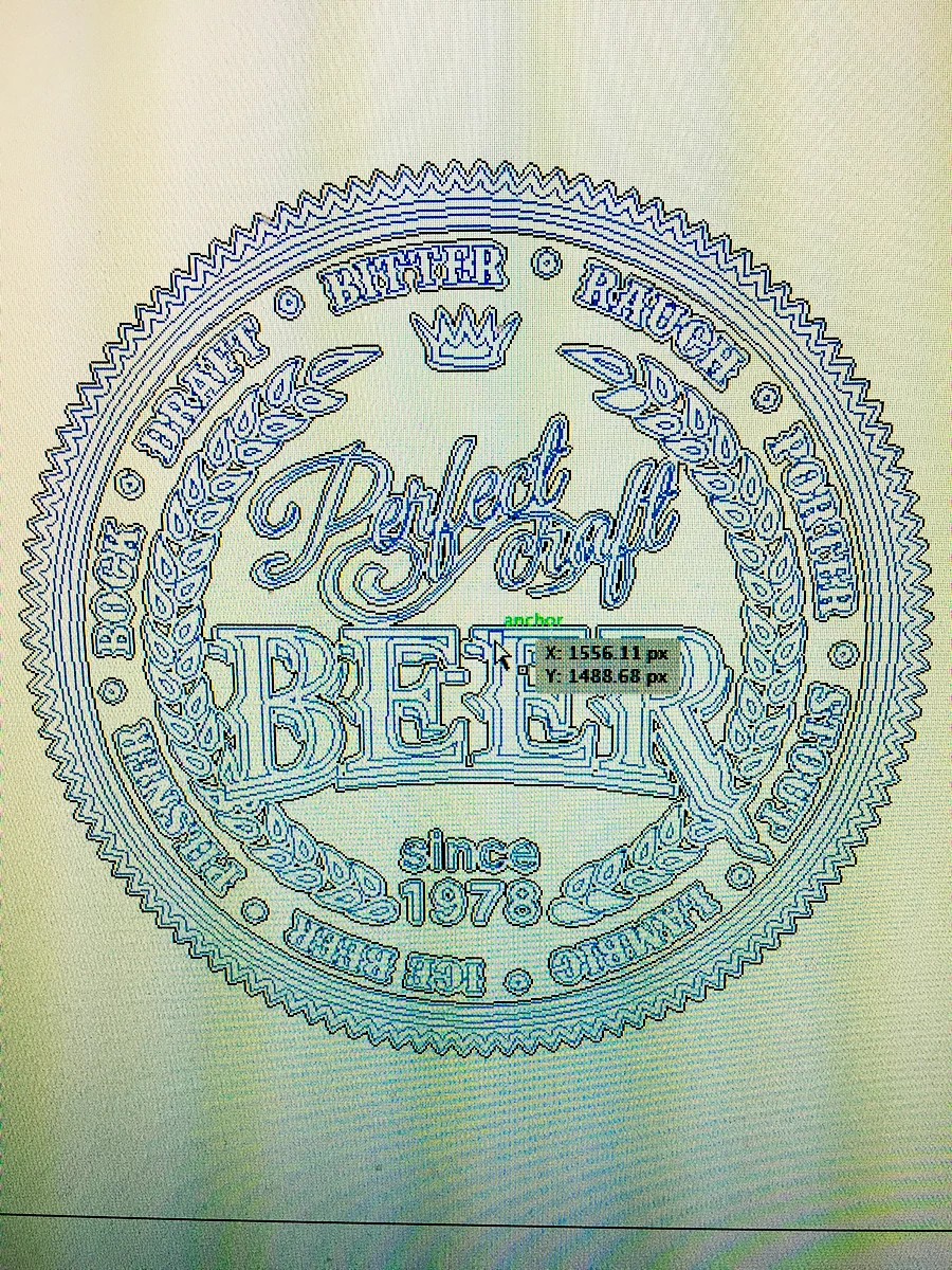

    While looking up a way to overcome a similar problem today I came across this post. I think (just think) I know what dcloud might have been asking or trying to do. I purchased a vector this morning on a stock image website. I needed to remove some of the text on the image (Not sure if I am allowed to do this, but it was Shutterstock 189558527 for anyone interested.)
    The image is made up almost entirely of compound paths, but when I release them (hard to explain this) instead of baing able to select each individual letter or point on the path, all I get is the blue selection line when I hover over the word. Nothing remains selected, and so editing it is not impossible it seems, but the only way that I am  able to do this is to go into the layers palette and delete what I hope is the right path. I actually tried this and ended up deleting things that I did not want to delete. So maybe this is that dcloud meant. It does not seem possible to edit any of the paths in the object or even select them. Selecting of the individual paths being the key. I have sat here humming Final Jeopardy for over half and hour and I am ready to give up.
    This was an older post, so if there is a solution to this and anyone knows the answer. And I would think that since all Illustrator objects are made of paths and points, that the original artist had to have used them, I would be greatly appreciative of an answer. Attached is a screen capture of the layers panel, but selecting any of these singular elements/paths is impossible.
    Thank you
    Monika Gause
    October 15, 2014
    kmgraphic schrieb:
    Most probably one of those paths is simply so large that it encloses all of the others. Go into outline view and do what needs to be done. Also: see the manual on how selection tools work.
    katethegreat10
    October 15, 2014
    Thank you -  I am not entirely new to Illustrator, so I feel I should know how to do this. Attached is an image of the artwork in outline, but I had to actually take a picture of this with my iPhone as once I move my stylus, the selection goes away. I have tried releasing the compound path, unlocking, expanding. I am at a loss as to what else to do.
    You cannot begin to know how much I appreciate your help.
    Since writing the above and while the site was down for maintenance, I have been able to expand it to the point where I can work on it, but it is still a nightmare and I could have created the entire thing from scratch myself in a fraction of the time that this is taking me. Again - thank you for helping

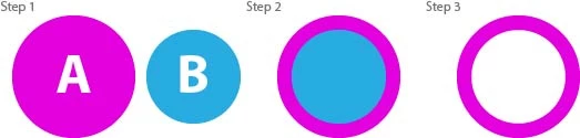

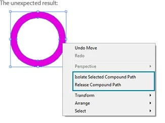

    Hi there people, I expect you guys dont crucify me, but I have the same problem that d.cloud had. I'll try to explain it better and for this i'll use this image:
    Step 1: There we have 2 circles, A and B. B is in front of A.
    Step 2: I had aligned B inside A.
    Step3: I used the pathfinder > Minus Front and got this result.
    Everything ok until now, the visual result of what I want is exactly that, BUT this shape (in step 3) is a compound path now, as we see below:
    I wonder if I needed this shape for making a logo, leave the compount paths on a logo is not the best think to do, right?
    Thats why I have the same problem that d. cloud had. Is there any possible way to convert this compound shape into a simple path? Or is there any other way for doing this shape giving the same result with a simple path?
    Thaks a lot guys!
    Doug A Roberts
    March 13, 2013
    maybe there is a reason not to have a compound path, but I can't think of it.
