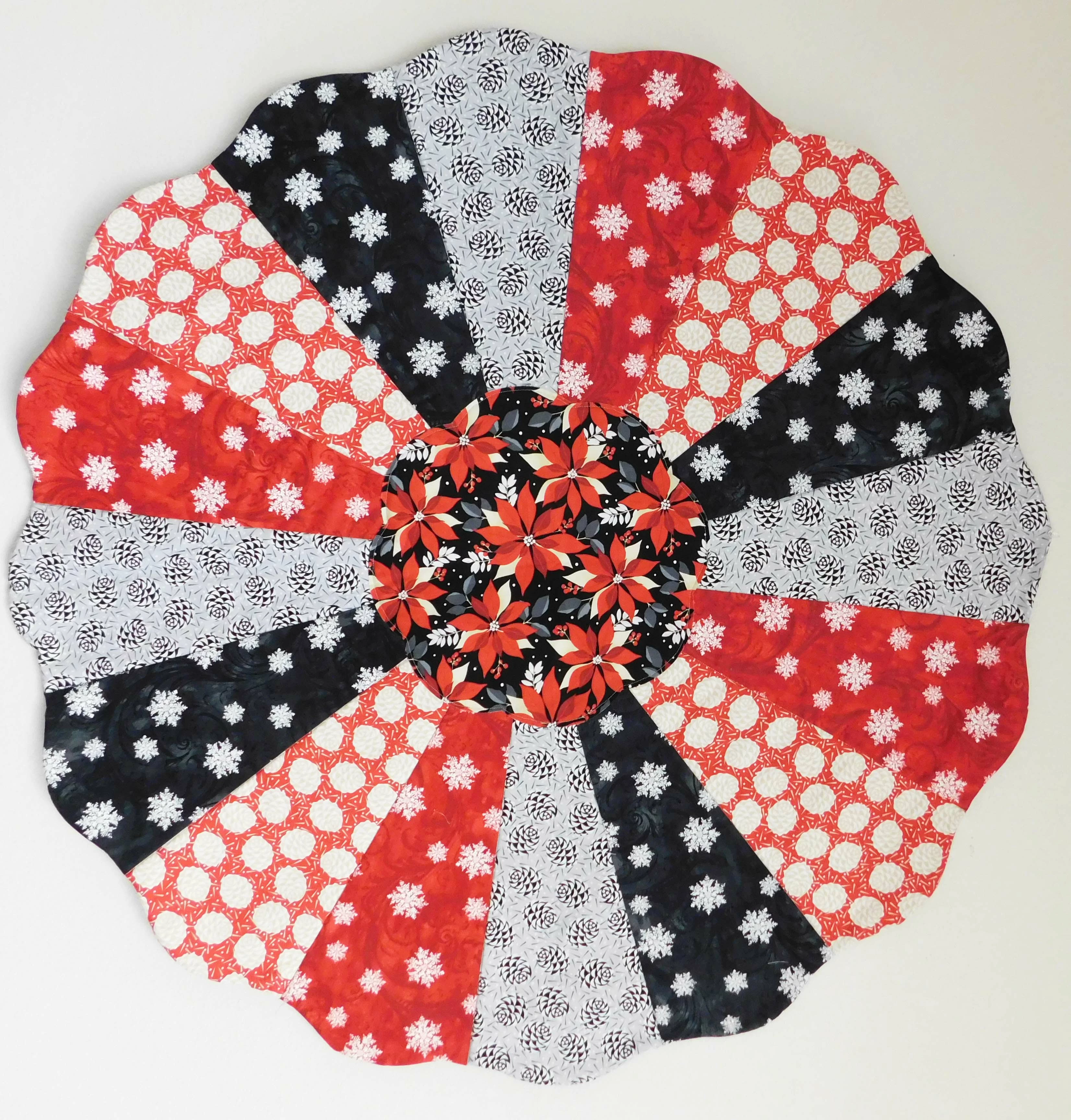

Bear with me, as I'm a very novice Illustrator user. I have a photo (seen below) that I am needing to turn into a vector graphic, allowing me to manipulate each shape by switching out the fabric in each one. I'm familiar with how to go about placing images into the shapes using clipping masks once I have the shapes created, but I'm just not sure how to go about turning each of these into the vector shape in order to do so. Does this make sense? Any input would be awesome! Thanks!!

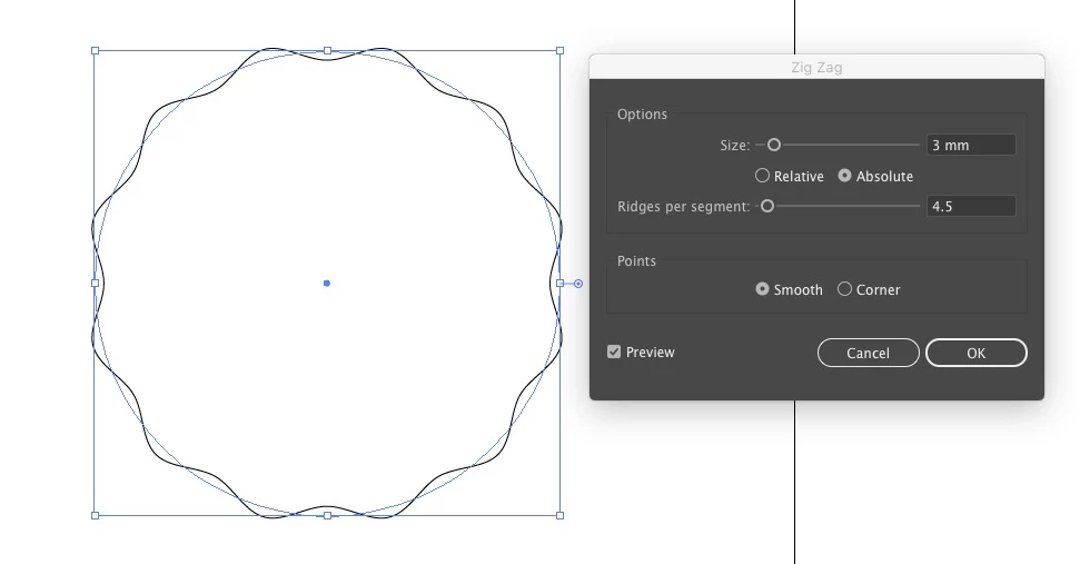

    draw a circle with the ellipse tool (L). hold shift to constrain it. go to Effect > distort & Transform > Zig Zag and use these settings. you might need a different Size depending on the scale you're working though:

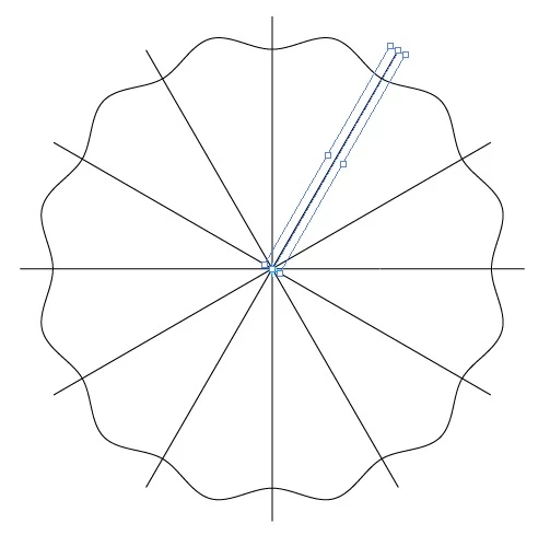

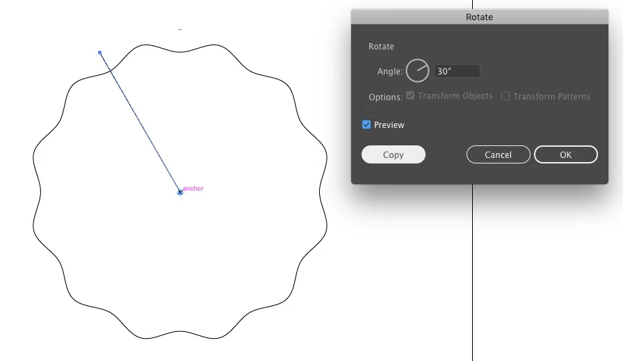

    make sure smart guides are on (View > Smart Guides). draw a line from the centre of the circle to the outside, overlapping the circle's wavy path. doesn't need to be accurate since we'll get rid of it later. select it and the Rotate tool (R). define the rotation point at the centre of the circle (alt + click on the centre). set up this rotation in the dialogue box that appears and click Copy:
    hit ctrl + D (Transform Again) to repeat the rotate & copy until you have lines going all the way round the circle:

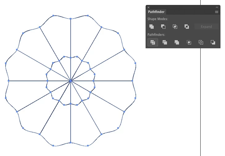

    select both circles and go to Object > Expand Appearance. this makes the wavy lines 'real' vectors as opposed to effects.
    select everything and in the Pathfinder panel, click Divide:

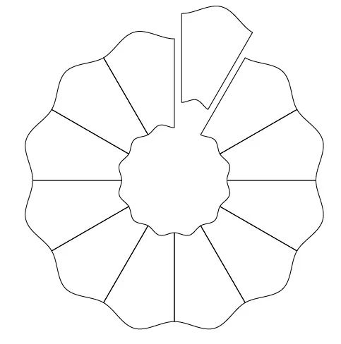

    this produces closed paths based on every intersection. select the paths within the inner circle you don't need and delete them. ungroup the paths and every outer section will be an individual path:

    Thank you very much! I'm familiar with using the clipping mask to place images into shapes. In the example above though that Dough so graciously drew for me, each of the outer "fans" as I call them, for lack of better term, are paths, but the middle circle is not since the fans combined together make up the circle. So, as far as I'm aware, it isn't possible to select the circle as a shape in order to make a clipping mask out of it. Again, I'm probably missing something though...

    I did try that...the problem I run into there is it traces each and every shape, including the little snowflakes and shapes with each pattern. I only there to be 17 shapes created...the center circle and each of the 16 main "fan outs" ...if that makes sense.
