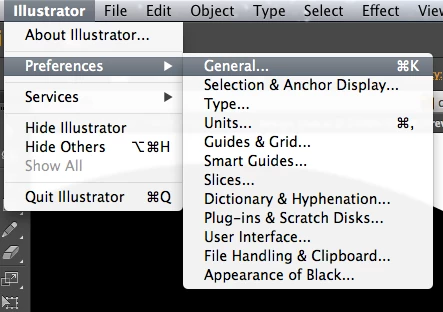

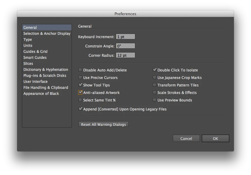

    Adobe Employee
    Mar 4, 2013 6:23 AM UTC
    You may also try going to Illustrator > Preferences > General and making sure the Anti-aliased artwork box is checked.
    Without the box checked:
    With the box checked:
    I hope this helps!
