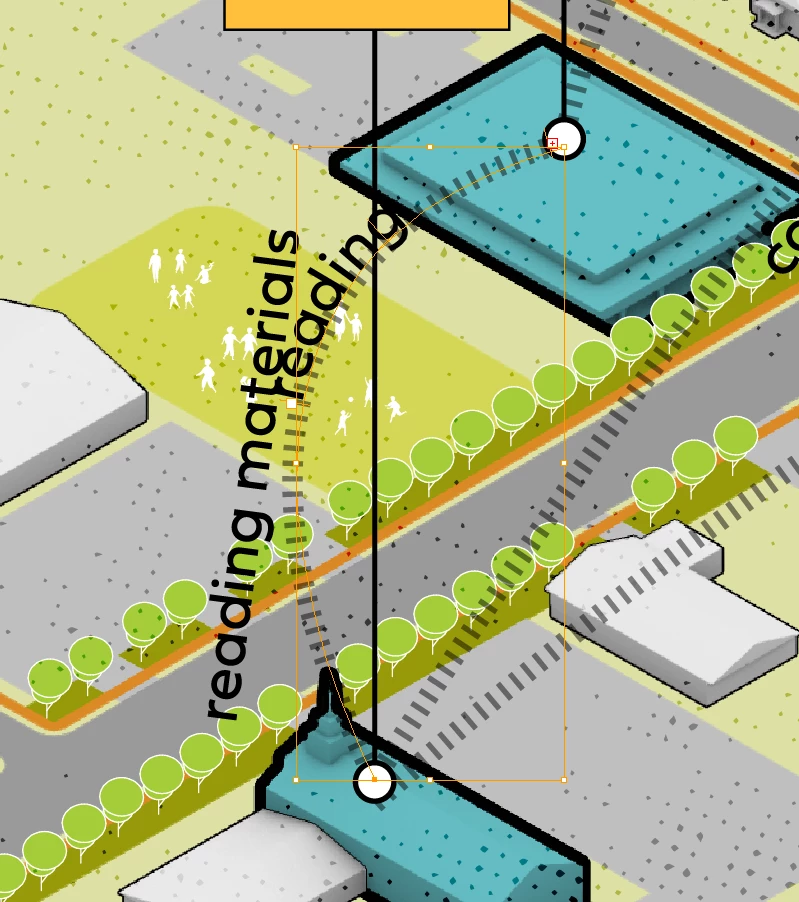

Hi! I am trying to place the text adjacent to the arc lines in the photo within the shape path of the arc. I have made a copy of all of the arcs and am using the type on a path tool to align the text to the arc. Even though I have played with the alignment and type>type on a path options, the text is biasing to one side of the arc. Even though I have typed "reading materials" on the line, only the word "reading" is shown and the rest of the phrase is falling out of the text box. If I try to extend the texbox, it just stretches the font.
How can I center the text on the arc so that all the words are visible? Thanks!

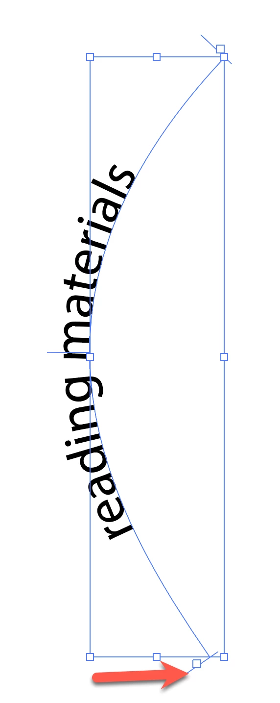

Type or paste your text. There should be a handle near the start of the type:

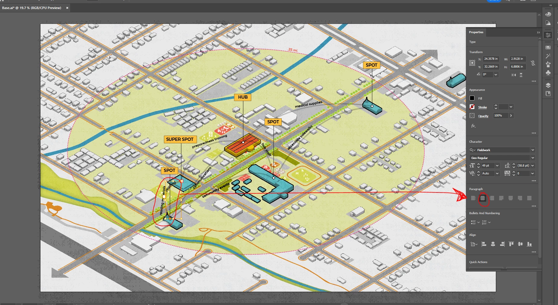

Drag it to the start of the path. Since you have Paragraph set to Align center, your type should properly align to the middle of the path.
Have I missed what the problem is here?

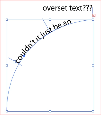

Couldn't it just be an overset text?

It is giving me the sign for overset text, but it isn't starting in the center of the arc, so it is not giving the text as much room as it should. I just tried to simplify the stroke (only has one midpoint now) but the same thing is happening. Here is a close up. I just incliuded the straight text off to the side for reference of the intended phrase.

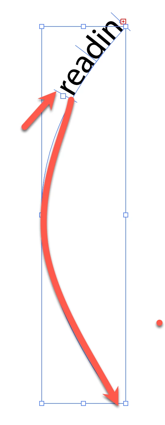

Now I'm pretty sure it's overset text.
  1. What happens if you click twice on the plus sign with the selection tool (black arrow tool)?
  2. Or - why don't you just move the starting point of your path text?
