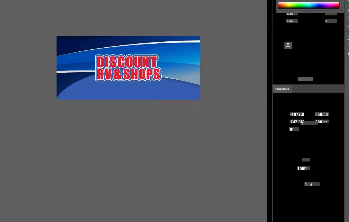

What's going on:
I occasionally get this weird graphical glitch with my UI on Illustrator. It's happened to me a handful of times, and I can't seem to find what's causing it. I've tried to replicate it many times, but it seems to happen at random. However, I found that the glitch seems to happen more frequently the more I alt+tab out of the app. I can't for sure say that this is the cause, because it genuinely feels that the glitch happens at random, even if I don't alt+tab.
The Problem:
I have made a video showcasing the glitch as it happens. (I blurred out any work-related files in my CC Library)

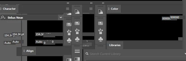

The app becomes virtually unusable whenever this glitch occurs. The UI will become black, and nothing is clickable. I still manage to get system prompts whenever I attempt to close the app, (save warnings, etc.) but they're invisible. The first sign that the glitch is happening, is that the font will change on the UI, taking the form of a "DOS-style" font. Whenever I see that, I know the glitch is about to happen, and there's nothing I can do to prevent it. Attempting to save will cause the black bars seen in the video.
In the video, I try to do various commands; Ctrl+Z, Shift+Ctrl+Z, Moving objects, etc.
Hardware & Software Info:
(All drivers are up-to-date)
DELL Precision Tower 3620
Processor: Intel Xeon E3-1270 v5 @ 3.60GHz
GPU: NVIDIA Quadro P2000
RAM: 32 GB
System: Windows 10 64-bit
Illustrator Version: 23.0.3
I realize there most likely won't be a hotfix to fix my very specific issue, but it's worth taking note of, in case this happens to anyone else. Maybe some staff can explain what's going on.
Either way, thanks!

Correct answer McNamara806
2024 UPDATE: Looks like I may have found a potential cause!
It looks like there's a GDI leak causing Illustrator to crash. I'm not an expert by any means, but I believe when these objects reach 10,000 Illustrator starts to glitch out. If anyone else is having this issue, could you please confirm by checking the prcoesses in task manager?
**Do this WHILE the glitch is occuring, do NOT close Illustrator while doing this, or it will not work!
  1. Open task manager
  2. Click on"details"
  3. Right click on a column. (like "status" or "memory")
  4. Click "select column"
  5. Check "GDI objects"
  6. Click "OK"
  7. Check the GDI number for "illustrator.exe"
  8. If this number is ~9,990 this could be your potential cause.
I will do some more observing, but this is the closest thing I could find to a possible cause. Perhaps a step in the right direction?

Posting here again because the problem still persists in the latest version of Illustrator. It's even happening on my personal computer, which is more beefy than my work computer. UI becomes completely unusable, with black bars appearing everywhere. Only happens with Illustrator. I have done everything from resetting my preferences, to launching directly from Creative Cloud. A fresh install doesn't seem to help, either. At this point, I'm very close to switching from Illustrator to another vector program. This has taken up too much of my time since August. I cannot go through a whole work week without this glitch happening multiple times.

Just chiming in that I have had the same glitch using Windows 10 (always updated), Illustrator 2020 (and previous versions), and nVidia GPUs (regardless of driver version). I just did a clean install of Windows and all of my software and system drivers, and the problem persists. I don't know what's causing it, but it seems like it happens over time during a long work session. Which, unfortunately, is every day.

Try Ctrl E to toggle GPU preview. Looks to the right of filename to see what mode you are ini.
August 9, 2019
Thanks for the reply, Mike.
Unfortunately, that doesn't fix the issue. The screen just stays the same, and flickers occasionally.
I wonder if the issue lies within the DELL Workstation I'm using. I used to have another DELL Workstation that did the same thing, specifically with Illustrator. The personal computer that I built, doesn't seem to get this issue. Which is bizarre, considering the prebuilt Workstation is technically better spec-wise. It could also be a huge coincidence.

Hi Orlie,
Thanks for reaching out. I could see that the panels are black. That's definitely not a usual behavior with Illustrator.
I would request if you can try the following steps and share your observations:
1. The first thing which I would suggest is turning of GPU performance from Illustrator preferences (Edit > Preferences > Performance ) and see if that helps. If yes, try updating the GPU drivers from NVidia's website: Download Drivers | NVIDIA
2. If that doesn't help try resetting preferences:
  • Close all Adobe applications.
  • Go to Locations C:\Users\user\AppData\Roaming\Adobe and.
  • Rename  Adobe Illustrator and Adobe Illustrator 23 Settings folders to Adobe Illustrator.old and Adobe Illustrator 23 Settings.old
  • Launch Illustrator from the Creative Cloud.
This way all your existing settings will be saved in old folders and Illustrator will launch with default settings.
3. If nothing works log in to Safe mode (How to Boot into Safe Mode On Windows 10 (3 Ways) - YouTube ) and check how it works there.
Looking forward to your response!
