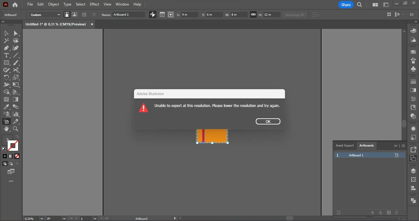

Hey guys!
I need some help. I just created a project in Illustrator and I need to export to a ruge dimension. Everything that I created higher than 4m, makes impossible to export in jpeg 300ppi (even less too). How can I do this right?
When I setup the project in 2 meters and make the canvas bigger than that, I can export, but I can't take a biggest canva because stops when I reach to the canvas bounds.
Correct answer Mylenium
Artboards cannot be larger than 227 inches in either direction. That's a hard limit in AI. The real question therefore is do you actually need 300 PPI on such a large artboard? Large format printing typically uses much lower resolution due to the viewing distance required. Unless this needs to be a super fine art print, it's more likely you would export it at lower settings.

I solved the same issue "Unable to export at this resolution. Please lower the resolution and try again (Illustrator) " I zoomed way out and I found some stray text way out in left field. I deleted the text an the issue was solved instantly !!
