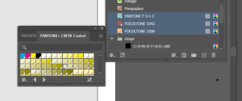

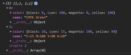

I have a script which show the color details of the selected swatches. I am able to get the color details of the default swatches
However, when I tried to add swatches from library..
the color details is blank..
Is there a way to retireve those data?
Here's my code btw,

Correct answer femkeblanco
The selected Pantone/Focoltone are SpotColors that have different properties to the colors your script is accessing.  The properties you are accessing are (an RGB example):
  • swatch.color.red
  • swatch.color.green
  • swatch.color.blue
  • swatch.color.typename (RGBColor)
For SpotColors, you want:
  • swatch.color.spot.color.red
  • swatch.color.spot.color.green
  • swatch.color.spot.color.blue
  • swatch.color.spot.color.typename (RGBColor)
  • swatch.color.typename (SpotColor)
Add a conditional to check if a color.typename is SpotColor and, if it is, go down the above route.
BTW, there's no JSON.stringify in Extendscript.  How are you reading the output?
