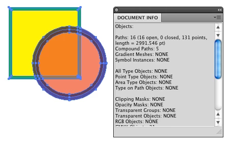

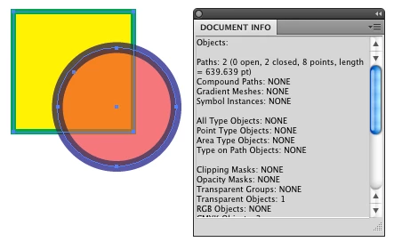

    Illustrator lets you use various transparency effects, like drop shadows, opacity masks, or simply changing the opacity of an object from normal 100%. The problem is that sometimes a print shop might not have recent software and hardware (although by now, “recent” means less than a decade). These older workflows can’t render or print objects with transparency, so the appearance need to be flattened, meaning the same appearance is created, but without any transparency.
    In the above example, I have two overlapping objects. The blue circle is using different transparency effects for its fill and its stroke.
    If I flatten it I still see the same image, but editing is a nightmare because it is now, ugh, 16 objects.

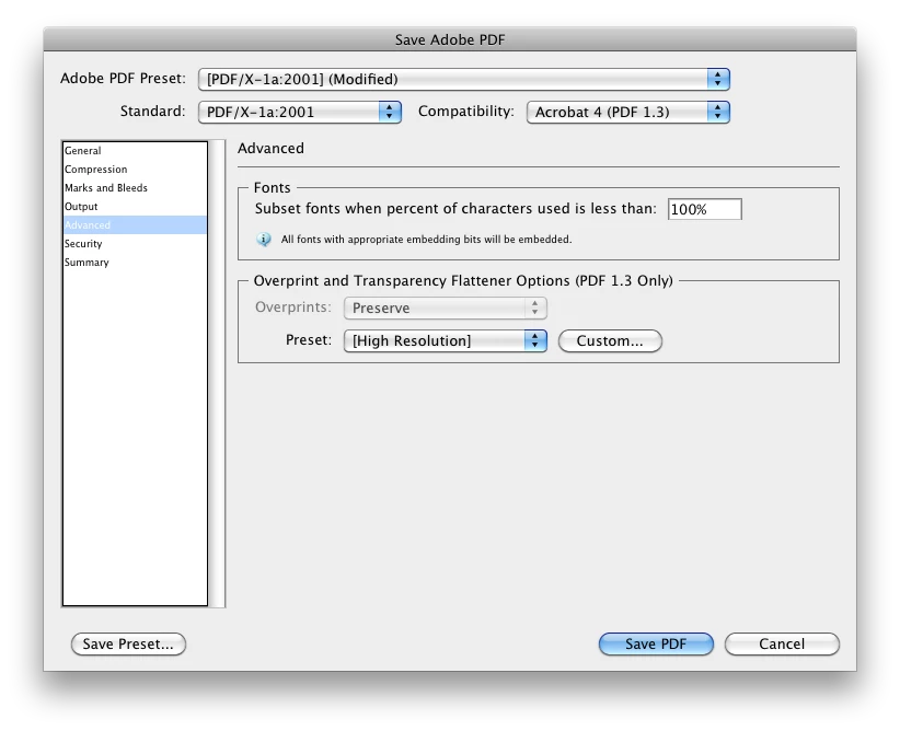

    If, however, you are saving a PDF for a printer and they reqire flattened artwork, you can take care of that on save. I suggest you use File > Save A Copy, choose PDF, then make sure the Compatibility is set to “Acrobat 4 (PDF 1.3)”. This version does not support transparency, so requires artwork to be flattened. In the Advanced panel you can choose te flattener preset Illustrator will use and, if you wish, edit it.
    Illustrator will then save your file as a PDF with all artwork flattened. If you used Save A Copy, then the original Illustrator file is unaffected and your transparency effects are safe.
