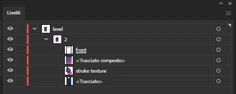

I have 2 EPS files inside of which there's a clipping mask containing several different items.
(here are the files if you want to test it)
File 1:
File 2:
As you can see the content is different but the structure is the same: a numbered clipping mask containing objects.

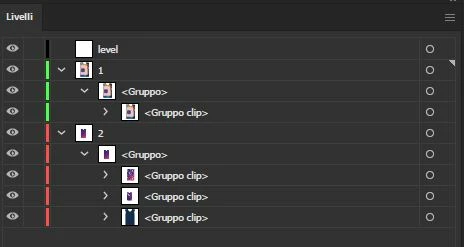

Now, if i insert these eps into an Ai file, this is what i obtain:
As you can see the content of File 1 stays in only one clipping mask while the content of File 2 is splitted in three clipping mask.
What i need is: always obtaining the result of File 1 embedding.
So, what's inside the clipping mask 2 that splits its content?
Thanks in advance to everyone willing to help me!

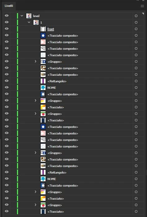

Yes, File 2 has more complex graphic than File 1, but is it really the reason behind that splitting after embedding?
What is the maximum point of complexity (amount of anchor points and paths) after which it starts doing that? I honestly don't see the logical correlation between complexity and the outcome of embedding.
To me it looks like the reason has to be found in the composition of the clipping mask (object inside other object) or a specific object inside of it.
But as much i try it, i can't spot it .
Can you or anybody else spot it?
There must be a logic.
For example, while testing i discovered that: if i put a clipping mask inside the Clipping mask 1, the embedding put that clipping mask out of it generating so two clipping masks. This is something i can understand: no clipping mask inside the clipping mask. Roger that. But there are no clipping masks inside File 2. So what's the reason in this case?

In my file there will be more than just one clipping mask embedded. After the embedding, since this process deletes every items name, i have another script to rename all the clipping masks in numerical order. I rename them because then i have to manipulate them via a script that recognize those names.
Now, the amount of clipping mask has to be always the same otherwise the last script will manipulate the wrong clipping mask.
For exaple:
CASE A: i have 3 clipping masks just like the File 1, after the renaming i will have this composition:
01 (from clipping mask 1)
02 (from clipping mask 2)
03 (from clipping mask 3)
CASE B: i have 3 clipping masks and the first one is life File 1 and the others like File 2, after the renaming i will have this composition:
03 (from clipping mask 2)
04 (from clipping mask 2)
05 (from clipping mask 3)
06 (from clipping mask 3)
07 (from clipping mask 3)
The script manipulates all the clipping masks with the same name in a predetermined way, so in CASE B each content of the clipping mask 2 will be manipulate in tre different ways instead of the same way as i want.
