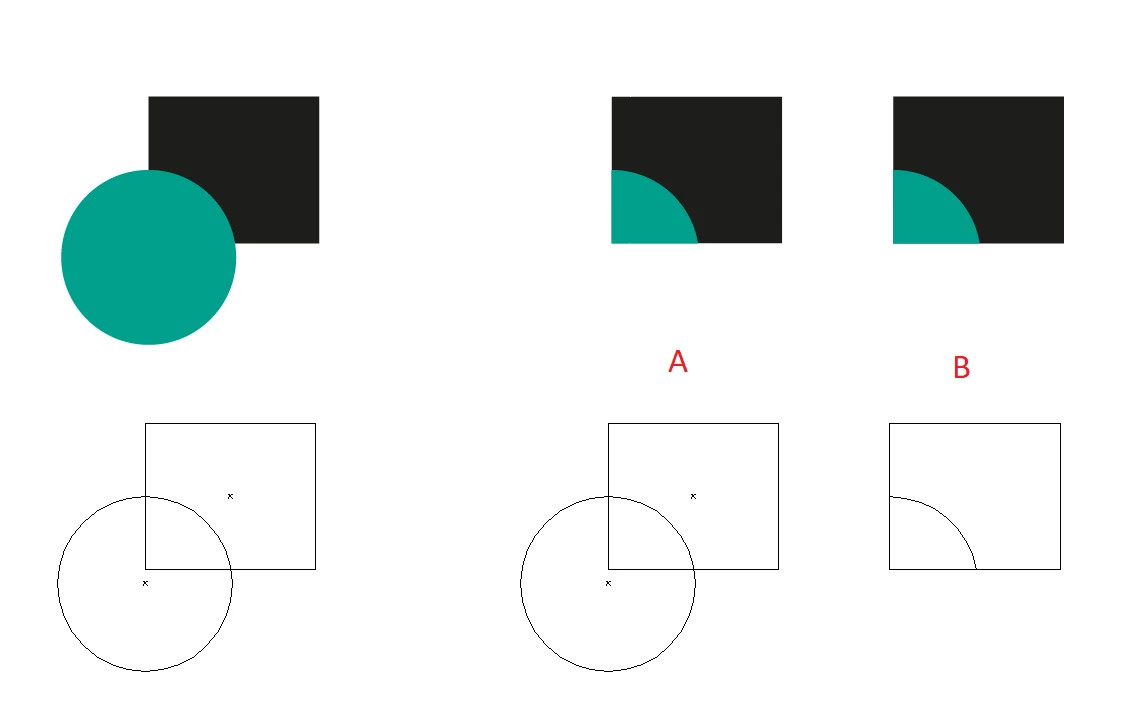

Hello everyone.
I was wondering if there is a way to remove vector (gradients,shadows etc.) and raster (sometimes with clipping mask) beyond certain dimensions altogether.So far we are using different methods like cutting vectors with shape builder or pathfinder,more complex vectors we need to rasterize then crop it to fit into  predefined dimensions,its long and tedious work.I was hoping there is a faster way to to this with maybe a plugin or diffrenete methods that I dont know yet.
Please see png attached (exmaple).
A. is what we get from our costumers.
B. is what we should get as the final result.
This is what we usually get and there shouldn't be anything (vector,raster) beyond the blue line.
Kurt Gold
Kurt GoldCorrect answer
August 2, 2025
No,this is the original file,hence why I am asking if there is a quicker way to remove all of the clipping groups beyond the red line without rasterizing it.Like I previously mentioned this is what we usually get and we try to avoid rasterizing it to avoid quality loss.
Thanks for the clarification.
Based on this sample file it takes just a couple of steps to crop the scene. Note that the following steps can be automated to a large extent with an action or a script.
  1. Select the clipped sun and lock or hide it.
  2. Select menu > Object > Clipping Masks
  3. Hit the Delete key to remove all clipping paths.
  4. Select all, then Object menu > Clipping Mask > Release
  5. Select all, then Pathfinder panel: Crop
  6. Unlock / Show and select the clipped sun, then Object menu > Rasterize
  7. Crop the sun manually.
As already mentioned, one can automate this process, but as you probably have other files that are built in different ways and thus may require varying / additional techniques, it's rather difficult to provide an instant approach.

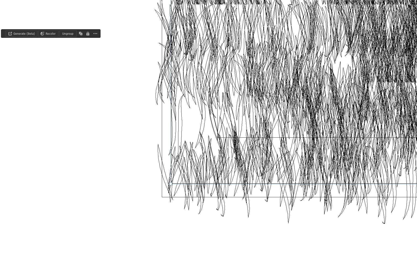

Can you share one of the more complex Illustrator files for inspection?
August 1, 2025
Everything beyond the red rectangle should be gone completely,even the unseen parts.
We usually rasterize this kind of things but then rasterizing things usually leads to lower quality of the final product.
In reallity no one will notice the difference but we still try to avoid doing this.
Kurt Gold
August 1, 2025
Unfortunately there is no download link in your latest post.
If you want to attach the file, make sure to save it as .pdf with the Preserve Illustrator Editing Capabilities option turned on. Or rename the original xyz.ai file to xyz.pdf
