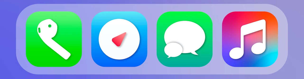

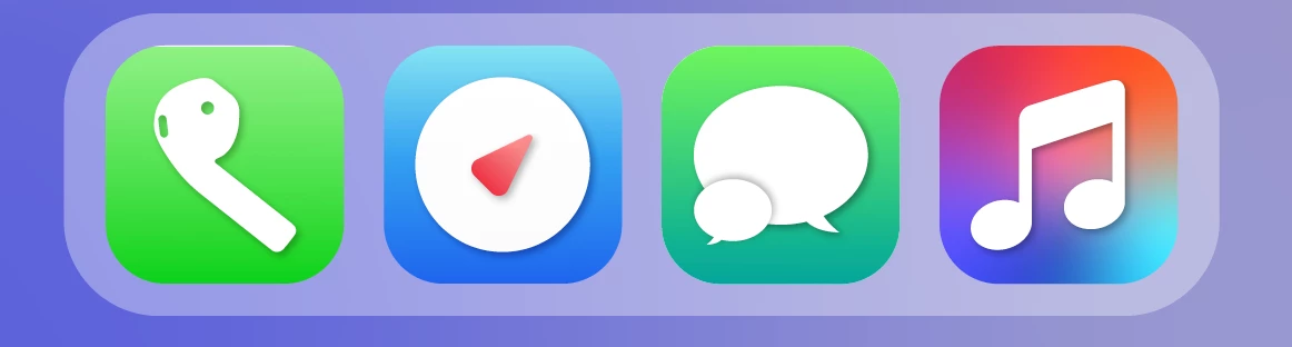

My document in Illustrator, is original in RGB color mode, because the purpose of the project is not for printing. But when I exported it to PDF, I found that the colors were a bit "washed out", colors were not as sharp as the color shown on the Illustrator document. When I tried to export it in JPG, it shows the exactly same colors as the original document.

Thank you for the explaination, I used "save as" as my method. So what should I do right now?
What happens when you include profiles?
Also: Apple Preview can show you if there's something in the file (but I wouldn't even rely on that). It won't be able to show you correct colors or anything like that.
For Acrobat: you need to check its color management settings.
Also: how are your color management settings in Illustrator?

July 31, 2020
What PDF settings are you using? What are you using to check the colour after exporting?
ccheng28Author
July 31, 2020
Thanks for reaching me out!
I used Adobe Acrobat and Preview(Mac default) to view the PDF, the color were still not as sharp as the JPG. I am not sure what is PDF settings, can you explain a little bit?
Thank you
ccheng28Author
July 31, 2020
1st is a screenshot of the PDF, 2nd is the screenshot of the JPG.
