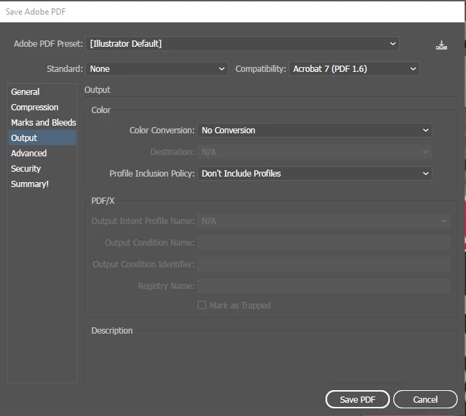

What happens when you include profiles?

I had the same problem with saving PDFs from illustrator and I went to OUTPUT when saving the PDF and set "Color Conversion" to "Convert to Destination" and it fixed the pdf colors.

July 31, 2020
1st is a screenshot of the PDF, 2nd is the screenshot of the JPG.
Depending on how you export exactly (Save As, or Export for Screens etc.) you should see a PDF settings window like this, with colour settings and other information about what exactly you're exporting.
