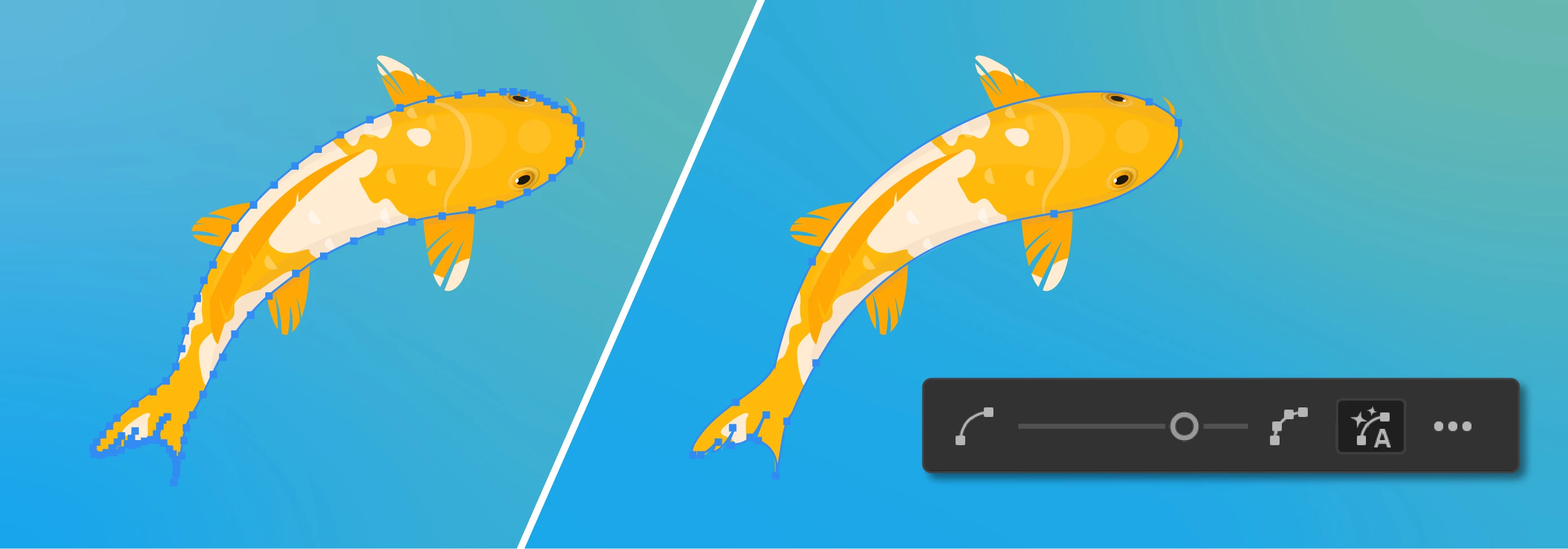

Use Path Simplification to reduce the number of Anchor Points
With the Simplify option, we can remove unnecessary anchor points and generate a simplified optimal path for our complex artwork, without making any significant changes to the path shape.
Simplify option would solve problems related to complex path editing.
Key benefits -
  • Easy and accurate path editing
  • Reduced vector file size
  • Faster file display and print
How do I simplify a path?
  • Select the object.
  • Choose Object > Path > Simplify.
Check this help article for complete details about this feature.

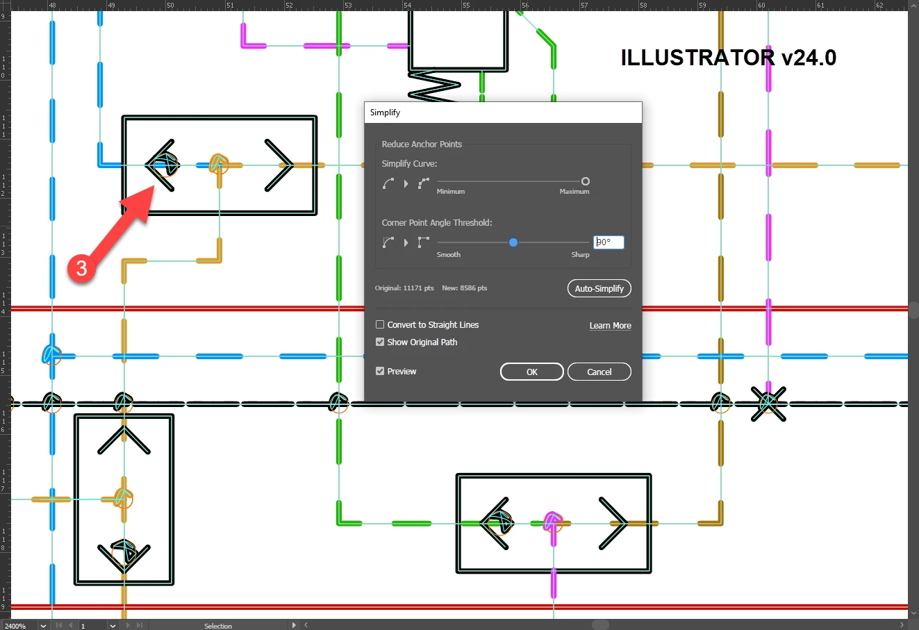

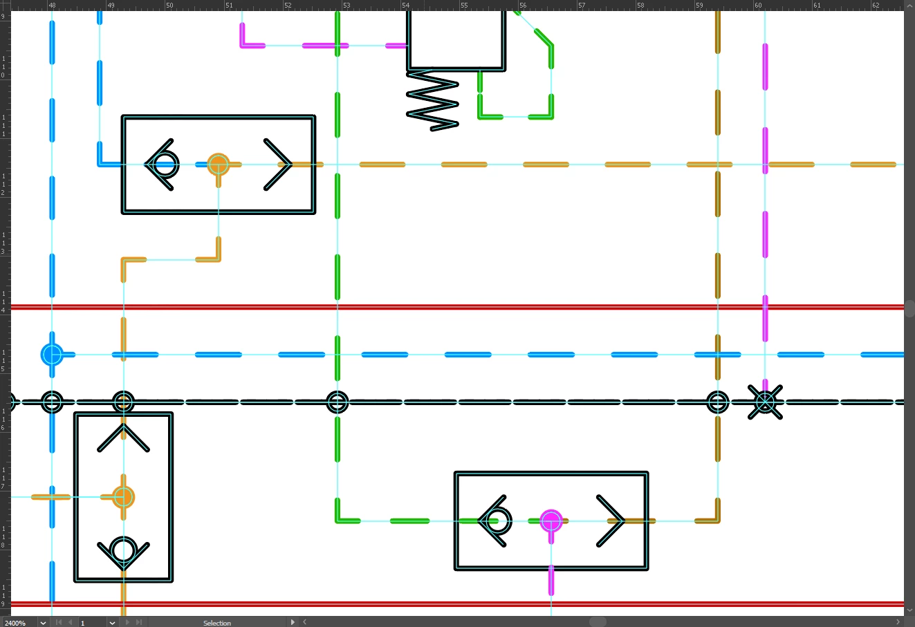

I am using simplify to reduce the file size with large vector images. Simplify in new v24.0 Illustrator is not keeping the shape of the vector image. An example:
This is how the image looks before simplify (all content selected):

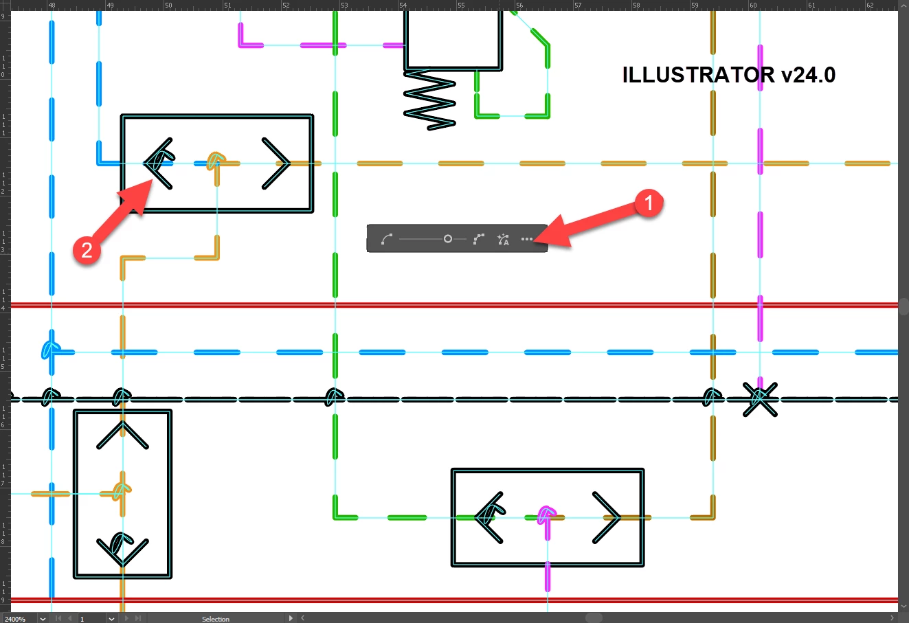

When I select Object > Path > Simplify, a new dialog (1) opens (images below) and for example all circles are reshaped (2). Even though I remove the Auto-simplify selection and open the More options dialog circles are not returned to the original shape (3). And the sliders does not have any affect to the reshaped shapes.

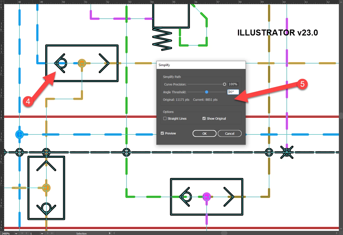

In the last image is an example how this looked like in the Illustrator v23.0. When the Simplify dialog (5) was opened the shape did persist as it was (4), or at least with sliders it can be set to be as it was and still the amount of points was reduced.
Also in other vector images, if the amount of points are reduced the image will be reshaped in v24.0. In v23.0 it was possible to keep the shape and reduce the amount of the points.

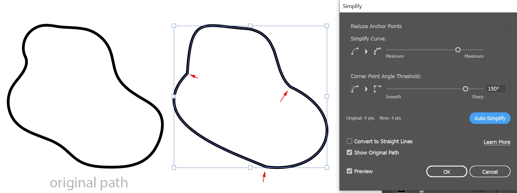

I am also having problems with the new Simplify Path: Oversimplification and introduction of new edges significantly changes the original shape. Adjusting the sliders for smoothness or angle threshold doesn't fix this.
I still have AI CS6 installed and even that gives better results without newly introduced edges.
