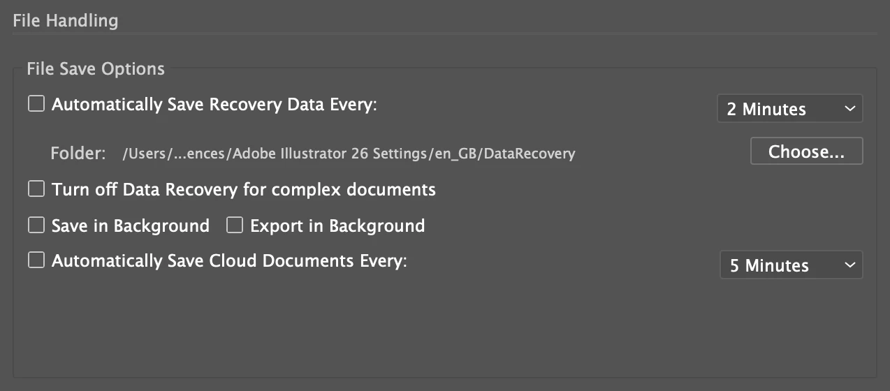

Hi all,
I'm trying to imitate the following preferences in Illustrator, disabling them all by using Javascript...
The following worked a treat, and do exactly what's being asked:
app.preferences.setBooleanPreference('CrashRecovery/AutomaticallySave', false);
app.preferences.setBooleanPreference('CrashRecovery/TurnOffForComplexDocument', false);
However, the following don't seem to work at all, where am I going wrong?
app.preferences.setBooleanPreference('enableBackgroundSave', false);
app.preferences.setBooleanPreference('enableBackgroundExport', false);
app.preferences.setBooleanPreference('cloudAIEnableAutoSave', false);
Any help would be much appreciated!
Cheers,
Sam

Looking deeper into the pref files @sttk3, something seems to be going wrong when setting the preferences using Javascript... There are 2 preferences files which Illustrator references when it loads:
• Adobe Illustrator Prefs
• Adobe Illustrator Cloud Prefs
The 'CrashRecovery/AutomaticallySave' and 'CrashRecovery/TurnOffForComplexDocument' preferences both exist in the Adobe Illustrator Prefs file, and when the above Javascript is run, this information is updated in the same file.
However...
The 'enableBackgroundSave', 'enableBackgroundExport' and 'cloudAIEnableAutoSave' preferences only exist in the Adobe Illustrator Cloud Prefs file, and when using the above Javascript, it actually writes new statements to the Adobe Illustrator Prefs file, instead of updating the Illustrator Cloud Prefs file. Yet, when there are specific preferences that only exist in the Illustrator Cloud Prefs file i.e. 'scaleLineWeight', manipulating this using Javascript keeps it in the same file.
