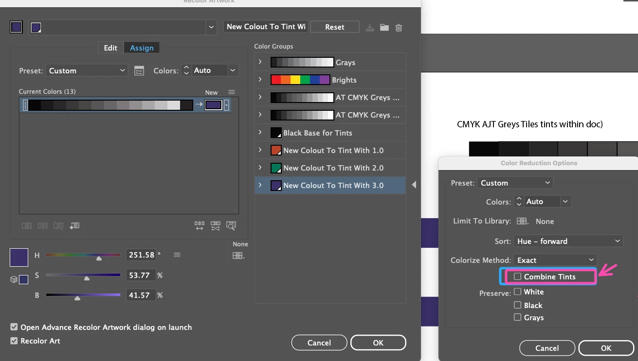

1. Combine Tints in the Colorize Method
Why would we chose to use or not use this option?
What does this help us to achieve?
Are there any examples documented?

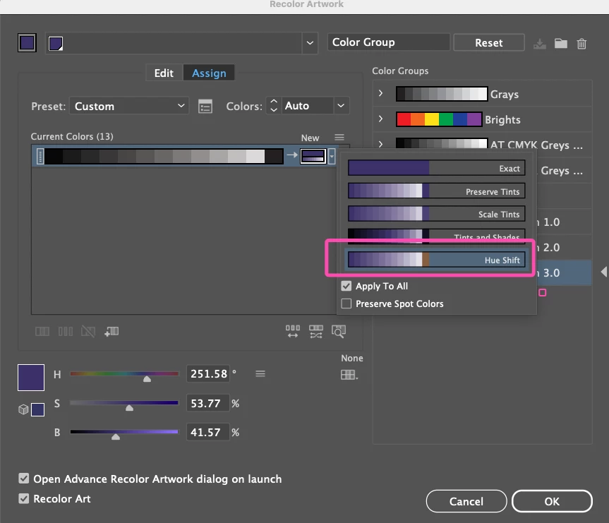

2. Hue Shift
What determines or where is determined the Hue that is shifted to?
In this case I have a purple colour to be applied and the Hue Shift field brings up a brown hue to shift to.
Where is this brown colour coming from?

The Hue shift will introduce a color shift when recoloring. You absolutely do not want that when your goal is black and white or when you want to preserve spot colors. Those two bottom methods are rather meant when you are exploring colors.
The other three are for more precise work.

Okay, thanks for your reply.  I already understood that it introduced a colour shift.
But what I was asking was: how is the colour to be shifted to defined/decided?
In my original question I gave the example of base artwork to be recoloured that is black and white. But with other artwork that is multicoloured, if I wanted to recolour them, what decides/determines the Hue to be shifted to?
Is the Hue to be shifted to decided by random?
Is it decided by a relation to the current selected artwork to be recoloured?
Is the Hue to be shifted to that of another artwork object I have unknowingly selected prior to opening the Recolour Artwork dialogue panel?
Or something else?
I am sorry if I seem persistent or obtuse in asking the question again. My only goal is to understand what possibilities there are with these functions so that I can decide what and how to use them.
If you or another expert user could possibly elaborate or show an example I would really appreciate it.   Thanks for any further information.

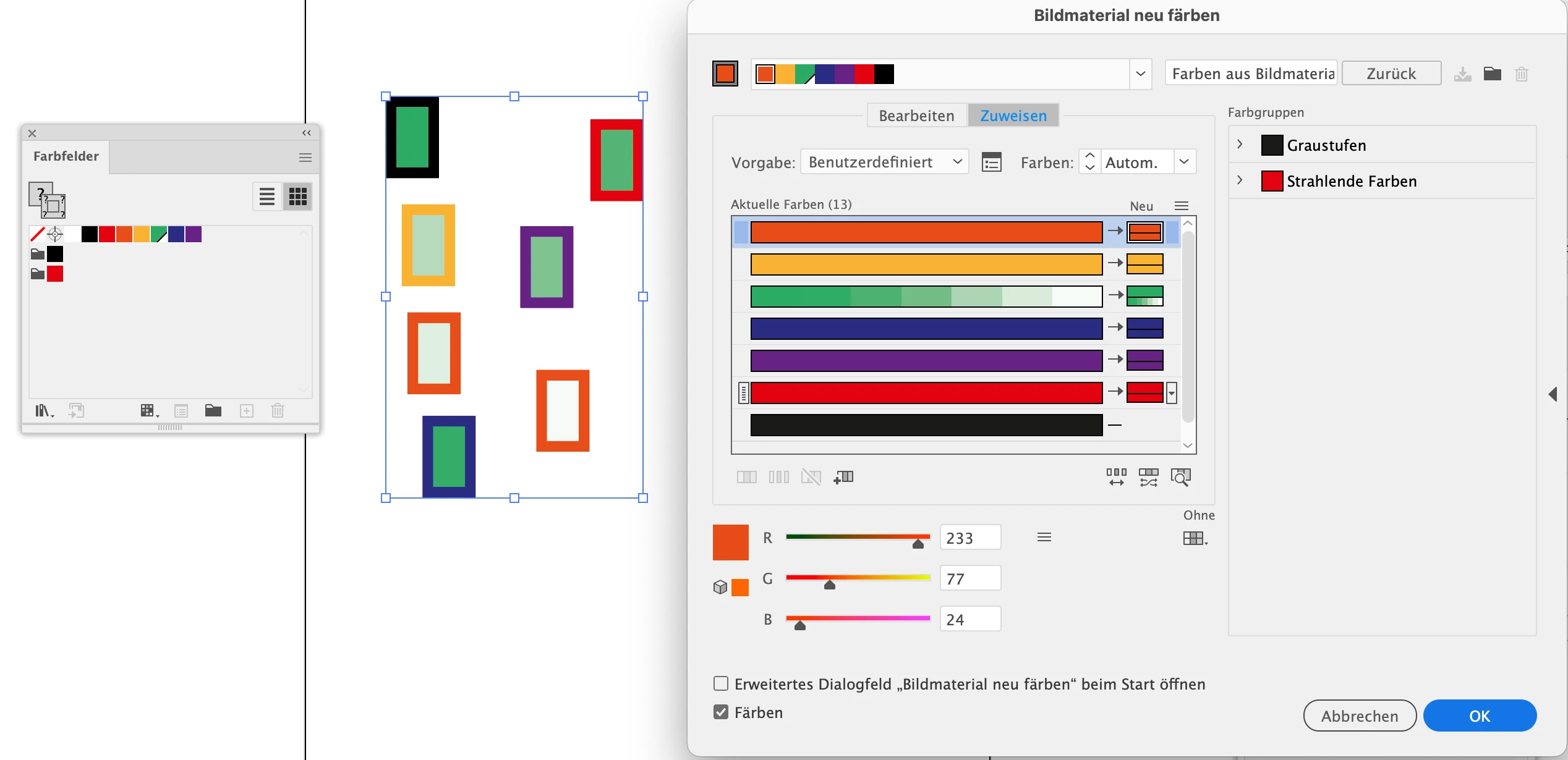

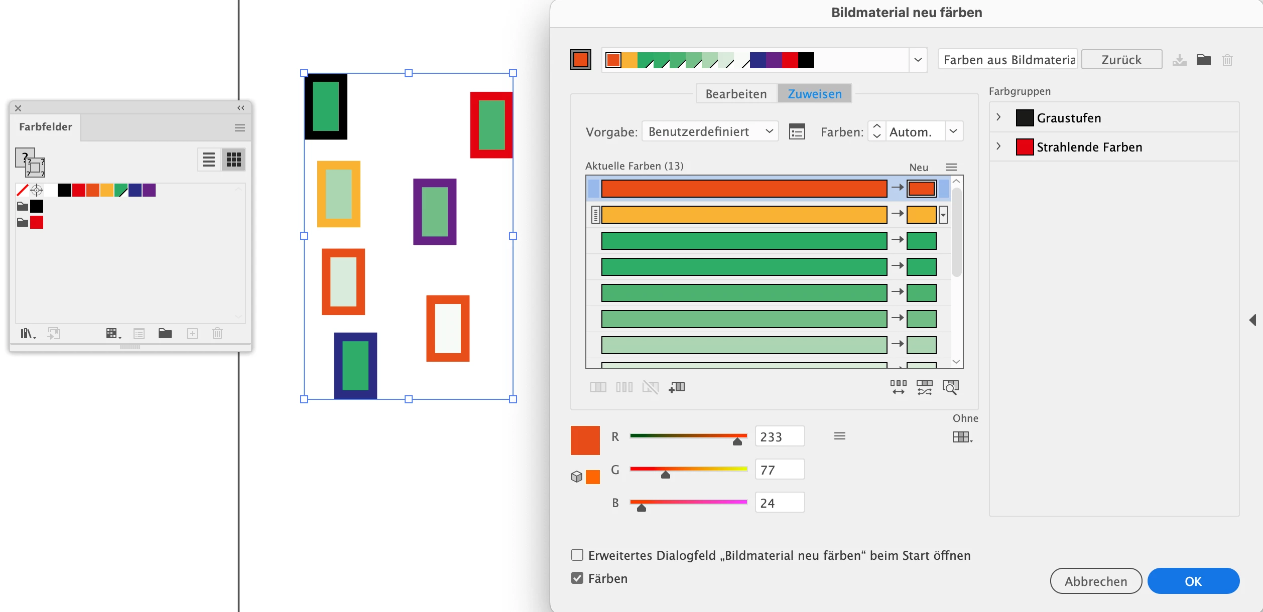

Tints combined
Tints not combined
amandathompson
February 8, 2023
Thank you very much for your reply and the clear screenshots.
So, the Tints Combined (or not) is when the artwork to be recoloured already has Tint colours in them.
I think I understand this better now.
