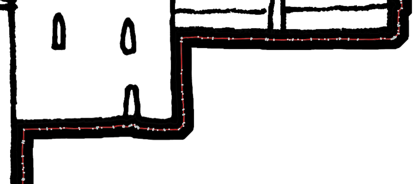

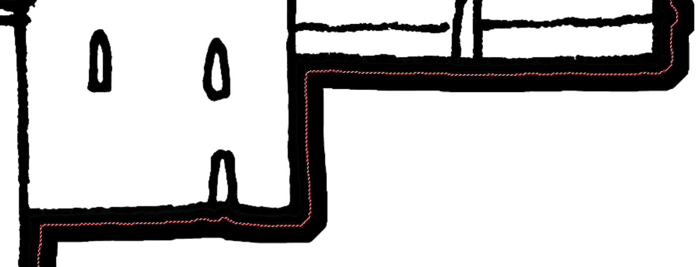

So as a workaround I am selecting the pixels as you can see below and creating a work path. All good so far.

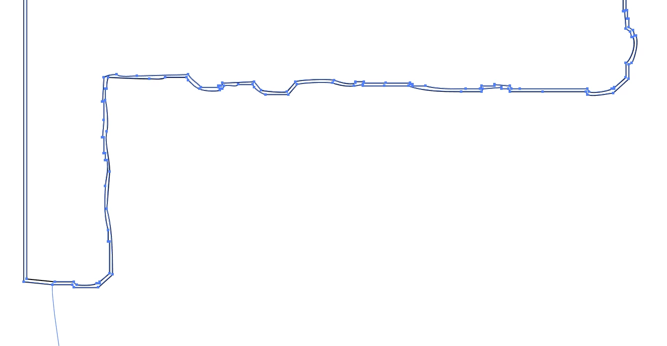

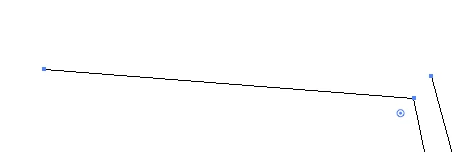

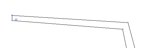

Then I export the work path to illustrator and open it. Naturally it comes in as two lines and a compound path, as the path takes either side of the pixel line in illustrator. This is where the issues begin. I thought that releasing the compound path would mean that i could delete one of the two lines and leave the other behind. This is not the case. You can see from the snap below - here I have released the compound path and selected the inner line with the direct selection tool. Weirdly, there is a line on the bottom left that seems to be vanishing away to nothing. There are no anchor points where the line ends and i can't select it.

    It would be helpful if you could show the complete path that has been generated and not only this small clipping.
