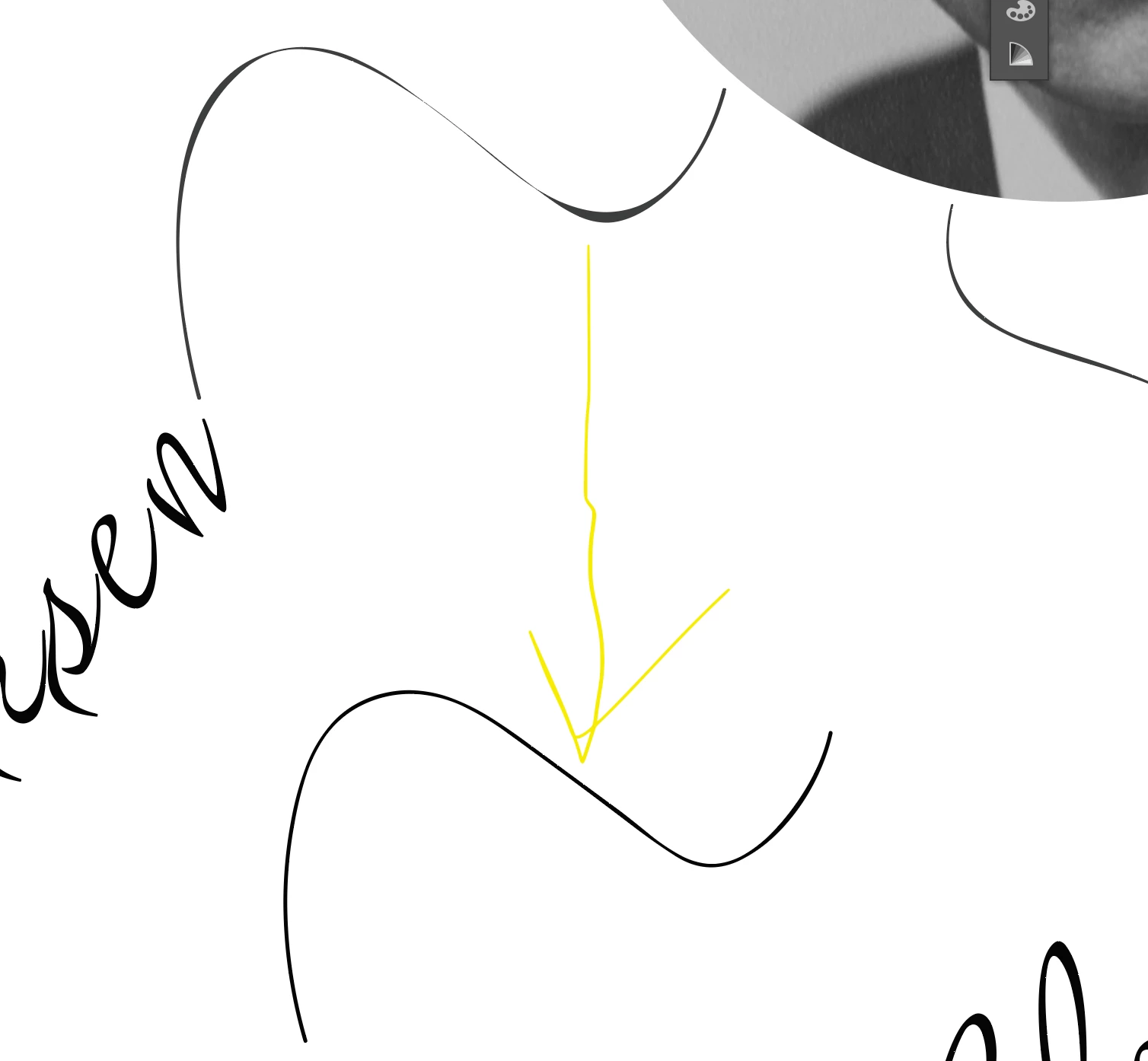

I started working on it again in the 2023 version of Illustrator. In the file I had made a lot of paintbrush lines. They were curved and automatically it appeared a nice effect: The thickness of the lines differed throughout the line. (Calligraphy effect).
When I started to work with the file in 2023 version, I saw that the same type of lines get much less variation in thickness. Even the lines I had allready made in the older version, changed, if I edited them in some way. (For instance I changed the color of some lines, and it made them loose the original variation in thickness!). If I make a copy of one of these lines and paste it, the copy is also different from the original.
What is happening? Doesn't this effect exist in newer versions? I see a small difference in thickness, but much less. How can I keep my original lines and at the same time be able to edit the color or the length? How can I make new similar lines?
I allready tried to open the file in 2024 version (suggetion from the support team, by the way, they haven't been able to give me a good support, thats why I write here). Didn't help.
See screenshot of original line (how I want it to be) in top of the screen shot, and the same line copied in the bottom.
Thanks, Stine

Calligraphy brushes do still exist, but there have been changes. That effect of thickening in curves was due to a bug. The engineers have indeed worked on the function to minimize that effect.
May 22, 2024
Oh really? That's a bit funny.. I made my design based on a bug.. They shoud have left it and made two options; one with thickness variation and one without!
