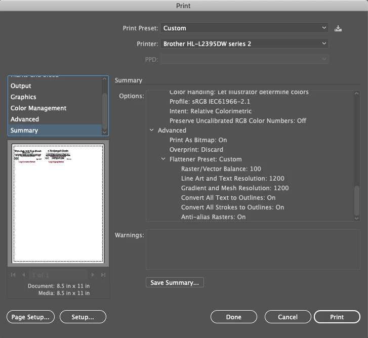

Here's a odd one... I have a iMac 21.5" running on Catalina 10.15.5. (it was 10.15.4 when I started this) using the latest version of Illustrator. When I print from Illustrator the images print in Bitmap. I’ve gone into the print settings, turned off the Bitmap selection and yet the printer still prints everything in bitmap. The first printer is a Brother HL-L2395DW (prints using postscript driver), I spent 4 hours with Brother tech support trying to fix the issue, updating drivers, switching different drivers. We were able to get the text to print clean with using a different printer model driver, yet the images still print bitmap. I ended up sending them test files to see if they would print clean, they came up with when printing from a iMac running 10.15.4 was the same outcome I had. I then decided to try a different printer, so I bought a HP Laserjet Pro M404, and unfortunately having the same results. Returned the HP printer, and I'm trying to get the Brother printer to print correctly. All of the other applications print fine.

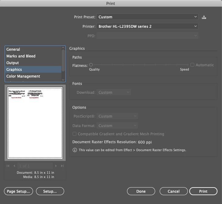

Correct answer Monika Gause

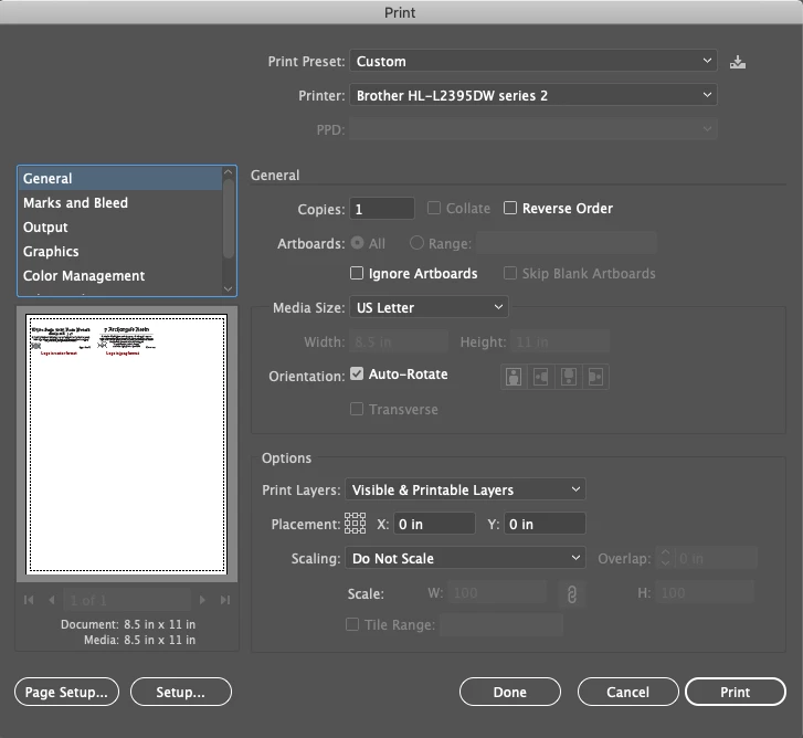

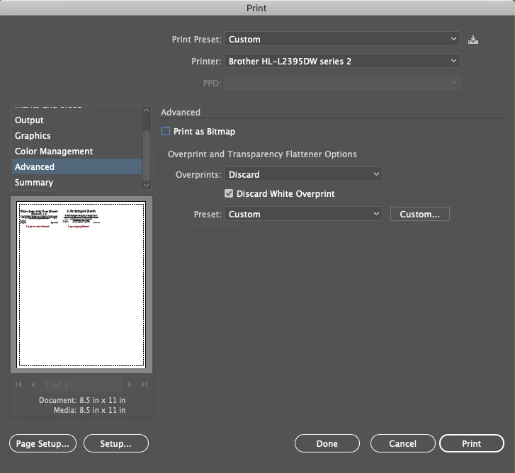

It's a Brother HL-L2395DW (prints using postscript driver). Here's the print settings.
"Print as bitmap" is deactivated.
Resolution doesn't seem to low, but your print size is very small. So you just have reached the limits of what is possible when printing.
If you want to be able tosee all the fine details in your logo, then lines would need to be thicker. Reduce the amount of detail and then you can reproduce it in small sizes.

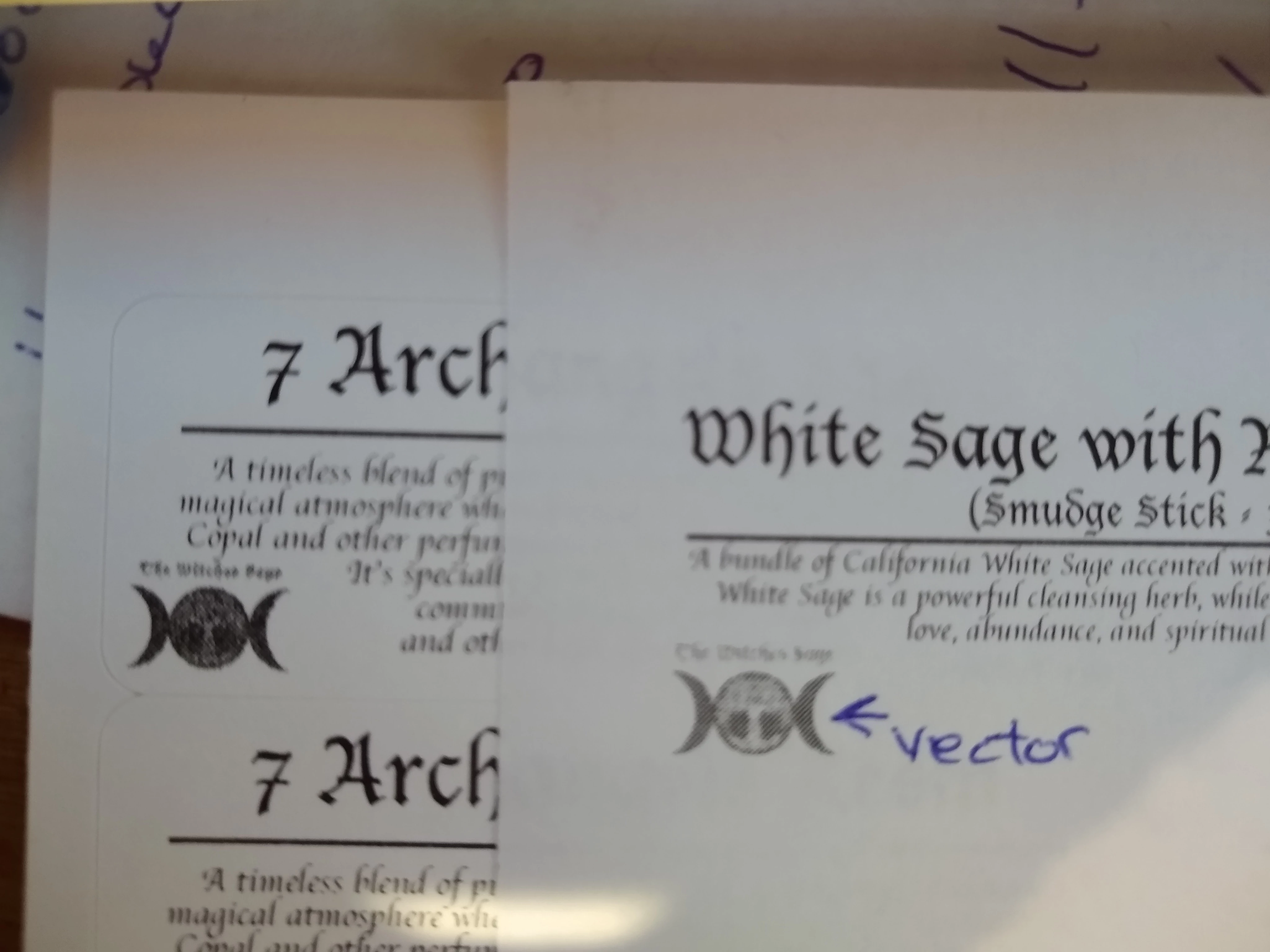

The files I'm creating in Illustrator are being printed from Illustrator. All of the files are then saved as .ai files. The file on the right in the photo was created in Illustrator, even the logo, yet only the text is printing clear. The image on the left was saved from Photoshop as a jpg at 600dpi, and sized down in Illustrator by 75%.

It's not "printing as bitmap". This is a halftone image.
It's not 100K black.

Actually, the image on the right is vector, and the image on the left is jpg. I'm printing from Illustrator. What's strange is that the file on the right was created in Illustrator, even the logo, yet only the text is printing clear.

What's happening is halftoning.
Your problem is that image that you have marked as "vector", right?
It got halftone screened by the printer.
