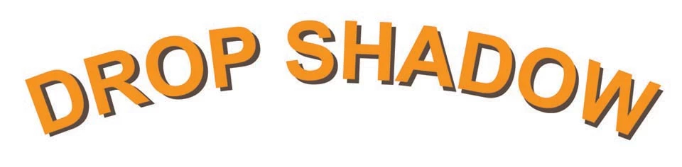

    Mike_zZ1Author
    December 8, 2018
    Here is the curved drop shadow without having to outline and manually position. I used the rotate tip and also scaled down the drop shadow on center and the produces a very even drop shadow.
    Thanks for the help.
    Jacob Bugge
    December 8, 2018
    For my part you are welcome, Mike.
    Your scaling the drop shadow down just the right wee bit is a crucial part.
    Thank you for sharing.

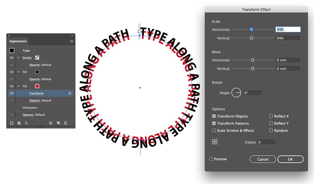

    Ton Frederiks
    August 3, 2018
    Something like this?

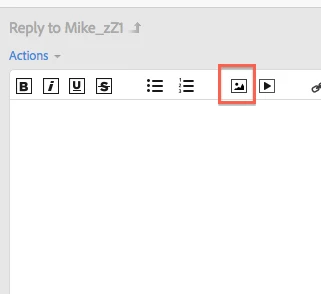

    Larry G. Schneider
    August 3, 2018
    Use the icon in the Reply dialog highlighted to add a raster image. PDFs and .ai are not accepted.

    Ton Frederiks
    August 1, 2018
    Without seeing what you find problematic, did you try to use the Effect > Stylize > Drop Shadow and set the Blur to 0?
    This creates a flexible vector drop shadow.
