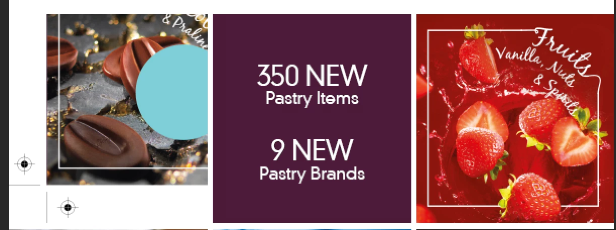

So since I've posted this I have been on the phone to adobe. Its happening in photoshop specifically from an INDESIGN copy and paste. Then when editing the smart vector from PHOTOSHOP, it opens in ILLUSTRATOR, I edit, then update the smart object and it updates with crop marks bottom left corner and the image cut off top right.
This is only an issue when copying from INDESIGN TO PHOTOSHOP AND BACK INTO ILLUSTRATOR. Not from Illustrator to Photoshop. Those files are fine
I have discovered that it is happening and I need to reset my preferences for ILLUSTRATOR, that worked when on the phone to adobe. It has since reoccured and I've not managed to resolve it again. i will have to get on a call with adobe again. See example below. I only added the circle to the image, look how it updates
